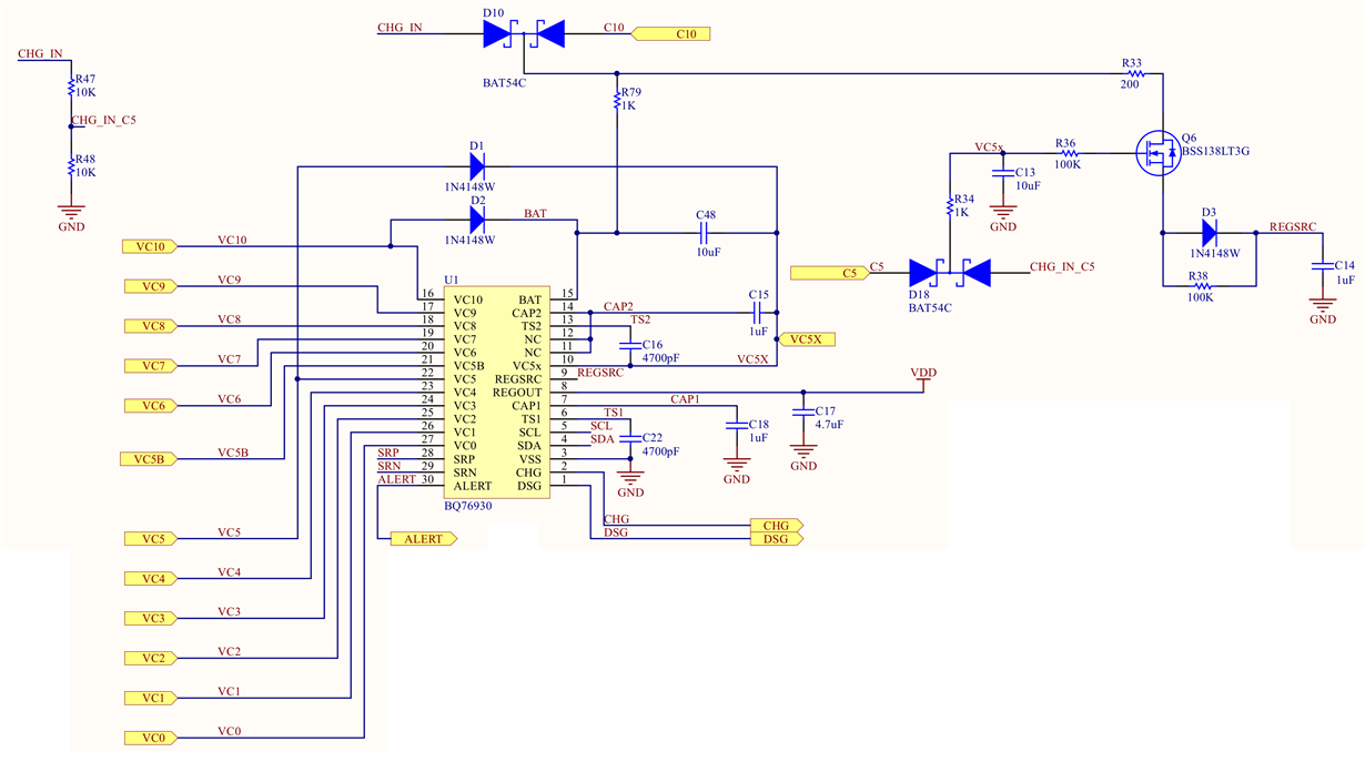

    However we might have found a mistake in the schematic that could introduce some transient voltage outside the absolute recommended for the cells. For booting the circuit when the cells are deeply depleted (when the voltage of the cells is not enough to turn on the BQ76930) we added a path from the charger to the BAT pin similar to the path from the VC10 to BAT pin, and also for the VC5x. (See the attached picture).
    Before the charger is connected the layers are off disconnecting the cells from the charger port, the voltage in teh BAT is the voltage on the VC10 and the voltage in VC5x is the voltage of VC5, as soon as the charger is connected, the charger will put 42V in BAT and 21V in VC5x (this voltage drops due to some resistor paths connected through VC5B and the cells 5) until the BQ76930 can produce the 3.3V to the MCU which is going to turn on the layers allowing the charger start charging the cells, at this moment the charger will adjust its voltage to charge the cells with 2 or 3 amps (depending on the charger). However, while the MCU is OFF and the charger is connected, the VC5x pin could have a voltage higher to the VC6 (and possibly also VCn where n=7,8,9 and 10), meaning that the voltage VC6-VC5x could be less than the absolute minimum which is -0.3V. We know already this is a mistake and we have already changed the design to prevent this situation, however we would like to know if this could be the cause of the ADC_EN clearing himself?

  • Hi Nicolas,
    Thanks for the insight from the schematic.
    If you exceed abs max it may have no effect, may reset, may malfunction, or may be damaged. Reset would set ADC_EN, so you would seem to be getting a malfunction.
    The bq76930 was designed with the concept that cells with an extreme discharge should not be re-charged. If the cell voltage is too low to boot the part won't work. Perhaps your MCU will use the bq76930 as a sensor when voltage is adequate. I'm sure you will find a good solution.
