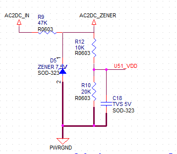

Our customer try to use external adapter and enable APD, but sometimes they found APD doesn't work even Vapd rise above 1.5V.
MayI know is there any possiblity that APD doesn't work even Vapd rise above 1.5V?

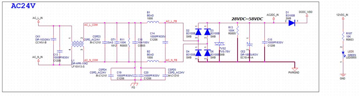

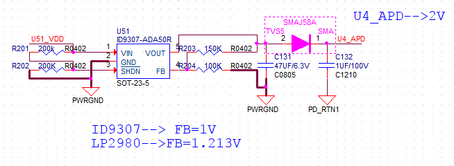

    1. Is this adapter meant to work with 24Vac & "28Vdc to 58Vdc" adapter noted on the schematic? Which adapter input is the customer using when they are unable to get the APD signal working?
    2. Is the "SMAJ58A" on the output of the LDO populated?
    3. Is there a special reason why they are using a zener with an LD instead of a simple resistor divider like in the Figure 1 schematic SLUA477? Is it to accommodate the 28V-58V DC voltage range?

  • Hi Tom,
    For your question:
    1. In this case is 24VAC only
    2. Yes, this is for voltage spike prevention. Sometimes the voltage spike comes out when external adapter inserting during the operatoion of PSE, and "SMAJ58A" can prevent APD pin from damage.
    3. Actually, this curcuit is leveraged from UPOE schematic. In order to prevent TPS2378 from voltage spike when external adapter hot-swap, so use the voltage clamping circuit as Zener and LDO.

  • Hi C.T.,
    Remove the TVS diode on the output of the LDO & see if you can attain the proper voltage on the APD pin.
    You only need to get APD > 1.5V.

  • Hi C.T.,
    1. To use APD, meet the APD voltage thresholds specified on page 5 & do not exceed the max APD voltage specified on page 4. Nothing else inside the PD controller affects APD.
    2. If APD does not work under these conditions, I would encourage the customer to order another IC.
