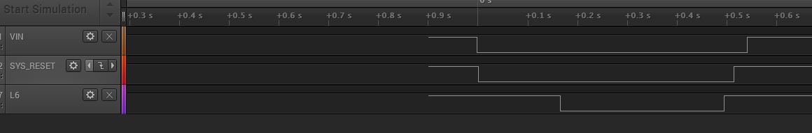

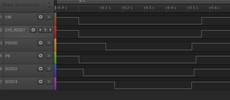

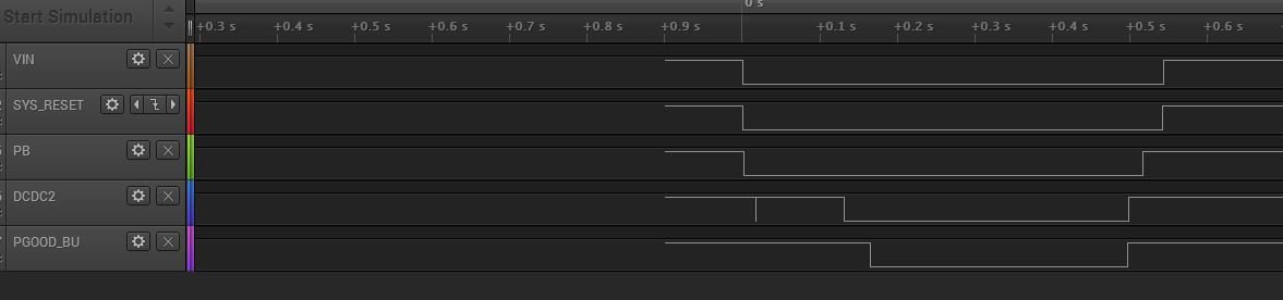

We didn't connect a R100k to GND with PWR_EN. There is no output when power on PMIC. We tied PWR_EN to high, then we got all power output. But the system keeps reset. Is this related to PWR_EN pin connection?
Thanks.
Thanks.
Hi Brain,
Thanks for your help.
We tied PWR_EN to high and AC_DET to low.
The VIN is applied to VIN_BIAS, VIN_DCDCx(1-4), VIN_LDO1, IN_BU.
In our original design, we connect PMIC_PWR_EN with RTC_PMIC_PWR_EN. But now we tied to high.
We use TPS65218D0.
I'll send you our sch file soon.
Thanks.
Carleen
BC4_Page15.pdfWe captured but may not very accurate. But we see the first one abnormal is VIN or SYS_Reset ( RESETIN_OUTn). Please attach capture file.
