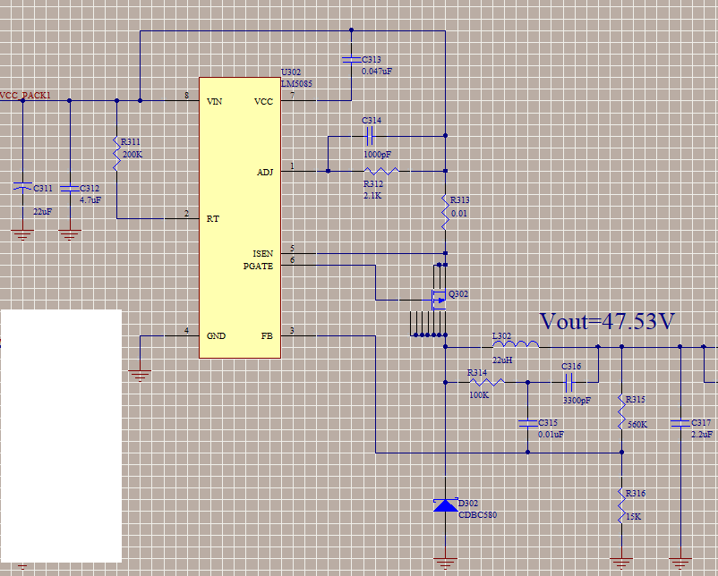

I'm using LM5085 to make a buck converter.
The input voltage is 60V , the output is 48V and the Current is almost 7A.
I have used 3 LM5085 totally, but there is one getting destroyed when powered up.
Please check the schematic listed as below.

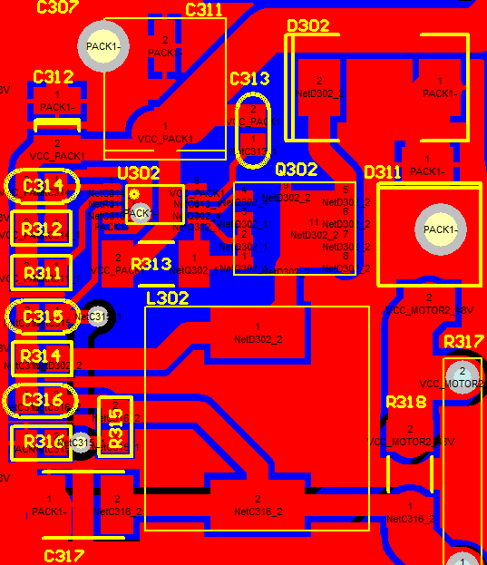

The PCB is listed as below
Would you please have a check?
  • Hello Wu Shi,
    On your schematic,
    1) Your VCC cap is small. Recommended is 0.47 while your value is 0.047. Since your operating frequency is relatively high, an 0.47 uF should be used.
    2) Could you please let us know what power FET you are using.
    3) Could you please let us know the manufacture’s part number is for C311.
    Layout,
    1) You are using a package without a DAP at high frequency – is your chip getting hot?
    2) Ground connection looks poor, how many vias do you have?
    Regards, Robert
  • Firstly, thanks a lot for the response.
    A:OK.I'll have a test with 0.47uF
    A:The FET we used is Si7469 ,released by Wishay. This FET is also recommended by ti on the reference design.
    A:In fact,C311 is a electrolytic capacitor of 10uF.
    Layout,
    A:In fact, we wants to buy chips with a DAP. However, the seller sent us samples without DAP.
    We have not tests with the load. Now, the chips are not hot without any load.
    A:Have you paid attention to the blue part? It's a big ground just under LM5085.
    There is only one via in this part.
    Update:
    We have changed C317 to a electrolytic capacitor of 10uF too.
    Of course, we also changed the damaged LM5085.
    Now, we can get the right output without any load.
    Do you still have any suggestions?

    Your circuit’s behavior may not have the same root cause as that for Wu Shi’s circuit which appeared to be a problem with the BOM.
