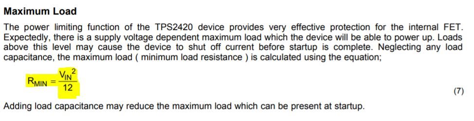

    I think you are violating the below condition,
    Please share the schematic if possible.

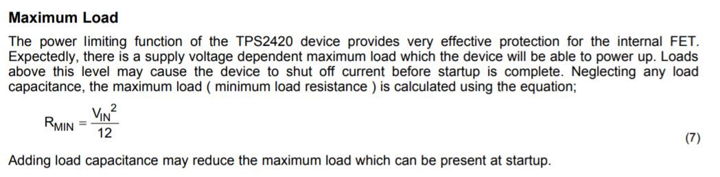

  • Hi Yusuke,
    As expected,  your load is causing the device to shut down during start-up.
    Coming to your question on how much Current is allowed during start-up,
    1. From formulae (7) of datasheet, the minimum resistance during start-up with 17Vin is 24 ohms. Which means ~700mA  of load can be drawn without any  output capacitors.
    Depending on your output capacitance, the current limit further reduces as the capacitance draws .
    From the waveforms you shared, it looks like your Load has an UVLO at 5V. When ever Vout reaches 5V, there is spike in Current and the controller is trying to limit to 5W power limit i.e. the current is being clamped to  ~400mA at a Vds across the FET of 12V (17Vin-5Vout) . Once you remove the load, the current respective to 5W limit is sufficient to charge the output caps before the timer expires.
