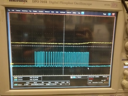

  • Appreciated your answer! Now I power up the board use two power source. One is for driver IC and the other is for Vin. But the board looks into hiccup mode.
    Yellow is Vdd and blue is output of optocoupler. Can you see what's problem? Thanks.

  • Hello GongSheng,
    I see the waveforms are operating in the "hiccup" mode, due to some unknown fault protection. Because several different faults at start-up result in the same symptom (VDD hiccup), the root cause of the shutdown must be diagnosed and corrected.
    One clue might be the NTC input voltage. 47K should be a good resistance to start, but if you have any large capacitance on NTC, that can prevent start-up. Internally, the controller checks for NTC input voltage to be >2.2V at about 2us after REF rises to 5V. A large filter cap on NTC will delay this voltage rise and the IC may conclude that the ambient temperature is too hot.
    To avoid any ambiguity, please remove any capacitance on NTC and remove the NTC resistor itself until after significant debug of your system is complete. NTC can remain open-circuit. That way the NTC fault will not interfere with debug operations.

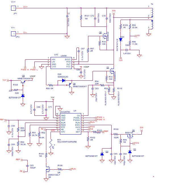

    Today I test the PWML of driver IC and RUN signal.  Attached waveform. When Vin is ~20V, there's one PWM, if increase to >30V, there's two PWM. Then hiccup.
    I also attached my part of sch. Can you see any problems?

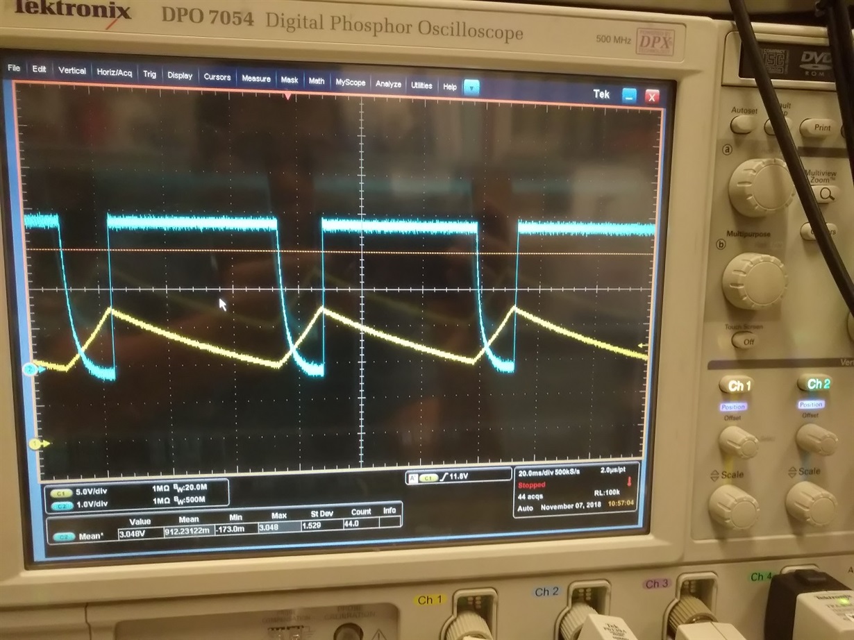

  • Hi Ulrich,
    I set Vbur=0.8V, Vcst(bur) should be 0.2V. But the measured value is 0.4V. What's a possible reason for this?
    Blue is the current sensing resistor voltage. Yello is PWM.
  • Hi Ulrich,
    In the design, I use MOSFET, but in order to reduce the delay, set pin is grounded.
    Any issues?
  • Hello Gongsheng,
    I am still travelling but I have a moment to address your questions which have accumulated. Starting with the schematic:
    - My biggest concern is the capacitor on HVG, C64. It is shown as 100pF, but it should be 2~2.2nF. The HVG regulator needs it for stability to regulate the 11V on the Q5 gate. (This low cap value may have indirectly led to your earlier start-up issues.)
    - My second concern is the 18V zener at D2, which should be a low-capacitance TVS (3~4pF) at 20~24V. A normal zener will add significant junction capacitance to the net and slow down the sensing of Vsw too much.
    - Third is that the values for RDM and RTZ (R91 and R92 ) are calculated correctly. I can't check that because you do not provide any transformer information (Lm, Llk, Np, Ns, Na). You don't have to provide this, but please double check your calculations and use the most recent values for the equation factors. (Designers often change the values of various components during debug and forget to adjust other components whose proper values are dependent on the previously changed ones. Abnormal behavior may then occur.)
    - Fourth is that the OPP adjustment resistor R94 is only 20 ohms. typical values are usually 50 to 100 times that, or more. However, I'm not sure what range it would be for a 30-80V input range. Still I think it would be higher than 20R. If the value is too low, then excess power can be delivered at high input voltage before OCP is triggered. If the value is too high then OCP kicks in too early at high line, and insufficient power is available.

    Concerning the current peak (CS voltage) at 0.4V despite Vbur programmed at 0.2V:
    This s most likely due to the driver propagation delay. If you display both PWML and LVG you can see the delay, which allows Ipk to go higher, even when PWML has gone low. The proper value of R94 (Ropp) will help mitigate the effect of this delay (and any others) for better Ipk control.
    Using SET = 0V for a silicon MOSFET power stage may cause some subtle trouble, since the timing parameters for switching are affected. GaN FETs react much more quickly and have very low Coss, so the timing with SET = 0 is appropriate. High voltage Si-FETs are slower and SET = 5V provides better timing control.
    However in your application, the 150-V FETs also have relatively low Coss, so the timing is relatively close that that for GaNs. It is hard to say if there will be significant trouble, but you may get better performance with one or the other. You may want to try both setting and compare. Refer to page 20 for details on the parameters that SET adjusts.
    Leading-edge blanking time may be the parameter that gives you the most trouble, if it is too short.

  • Hi Ulrich,
    First, very appreciated your time to address my question.

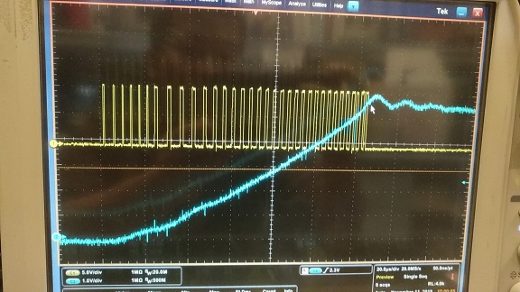

    1. For 100pF capacitor issue, I found it yesterday. And correct it to 2.2nF. Here is waveform after change.
    More pluses, but still in hiccup mode.
    2. Now I removed these zener diode on HVG and SWS.
    3. The spec is Vin=20V~80V and Vo=5V Io=2A. Np=8, Ns=2,Na=6. Lm=6uH. Lk should be ~5% of Lm.
    4. I didn't check this value. I'll correct soon.
    I'll let you know when I have any update. Thanks again!
  • Hi Ulrich,
    Change R94 to 820ohm now. The Vo can rise up. But looks trigger OVP.
    I change R96 to 8.4kohm, But the OVP voltage become lower, which is about ~4V.
    The waveform below is triggered at ~6V.

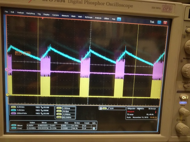

  • Hi Ulrich,
    Good news! I power up the board today.
    But when I increase a little load~0.1A, the voltage drop again and never get back. And the output voltage ripple is big.
    Here is the board works at very light load condition.
    Blue -Output voltage
    Yellow- PWM drive
    Purple- CS voltage
  • Hi Ulrich,
    Quick question.
    Regards to zener diode, I found in TI reference design also use CZRU52C20 zener diode. Does it cause any problems?

    For your Nov 12 post:
    Vout is rising up but continues to rise past 5V without “slowing down”. This points to a feedback loop problem. The cause of the shutdown is not yet known. Originally I suspected OVP shutdown (as you do), but your next post has evidence against that conclusion. The rising ramp up through 5V suggests an open-loop condition. Or some incorrect value around the shunt regulator circuit. This part is not shown in your schematic segment of Nov 8.
    For your Nov 13 post:
    This behavior is abnormal output ripple, due to a large-signal problem, not a small-signal instability.
    It resembles an OVP shutdown after each set of pulses, however it is not OVP because OVP would result in a shutdown interval of ~1.5 seconds.
    I suggest to look at VDD on the UCC28780 controller and see if it is following a similar pattern. If it is, then the auxiliary winding is not keeping the VDD bias voltage up as it is expected to do.
    The 12-V Zener D26 may be too low to keep the VDD voltage high enough after the Q3 base-emitter drop. Try a 13-V or 14-V Zener instead. (Or add a diode or two in series with D26 for a temporary test.)

    Unfortunately burst-mode cannot be disabled. However, the excess “ripple” that you are seeing is not due to burst mode. It is from some kind of large-signal instability that we have not debugged yet.
    This is not the normal behavior of burst-mode.
    Can you please an up-to-date schematic diagram of the full power stage? If you wish to keep it private, please email it to ulrich_goerke@ti.com. This will help me to assess the entire power stage circuitry for anything not right. Meanwhile I suggest that you verify that each component on your board is the correct value and that all connections are solid. Often, the schematic looks good but the board has the wrong part, a backward part, or a bad connection that causes malfunctioning. One recent case had a Tl431 shunt regulator misconnected because the pinning of the actual device did not match the footprint on the board, but the schematic looked okay. It pays to double check.
