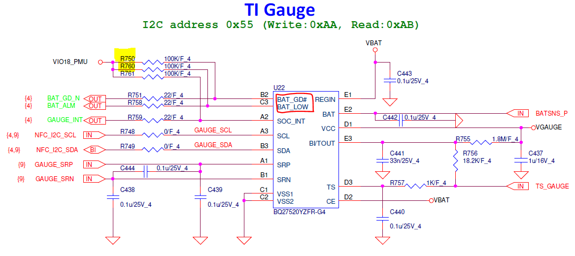

BQ27520-G4: Should BAT_GD# and BAT_LOW need pull high resistors?
Part Number: BQ27520-G4
Hi team,
BAT_GD# and BAT_LOW are push-pull output, does it mean pull high resistors are not needed?
Can I remove R750 and R760 as they are push-pull output?
Is the connection fine for other components?
Thank you.
  • Hi
    Those pins are pull -up internally i believe. I would recommend using a 0 ohm for R750 and R760 just in case i am wrong.
    I do not see your filter network on your srp and srn.. i see the caps but i don't see the resistors. I don't see pull ups as well for the sda and scl lines
    thanks
    Onyx
