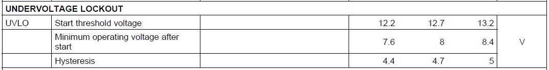

I would like to inquire about the operating characteristics of UCC2897A.

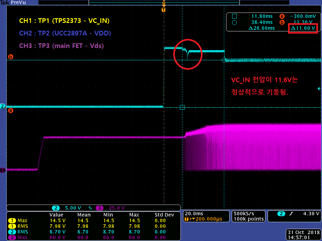

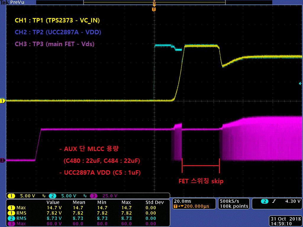

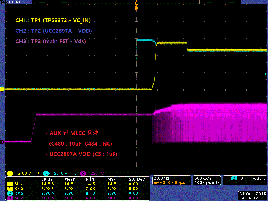

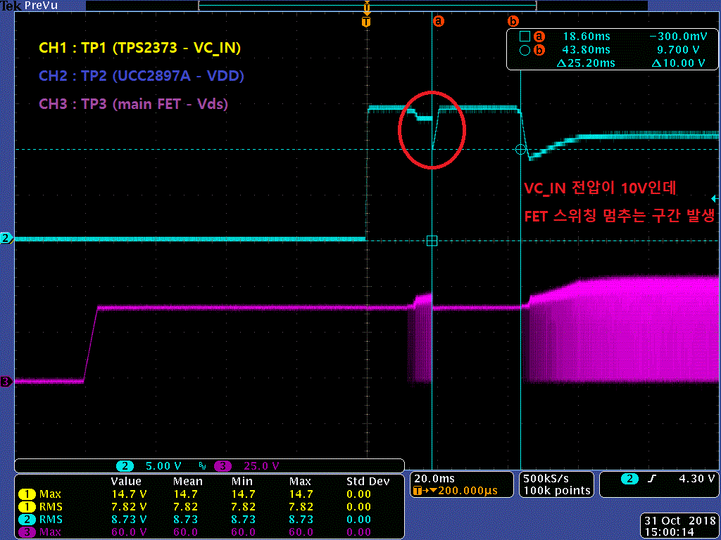

Test condition
1) When initial power is applied, TPS2373 VC_OUT voltage is applied to UCC2897A VDD and 15V voltage is applied.
2) FET switches and UCC2897A VDD drops to 10V.
Questions:
1) What causes the UCC2897A not to operate before the minimum operating voltage reaches 8V_typ after startup?
=> When VC_IN is changed to 10uF, UCC2897A VDD is 11.6V level and no problem occurs.
