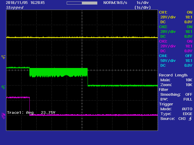

I believe that the operation of the IC on this evaluation board is Vout turned off at 512 ms after the current limit, is it correct?
However, in my evaluation Vout does not turn off.
Yellow:Vin=24V
Green:Vout
Red: Fault indicator
The marking should be ED04, ED05, but it is PD00.
Is this correct marking?
