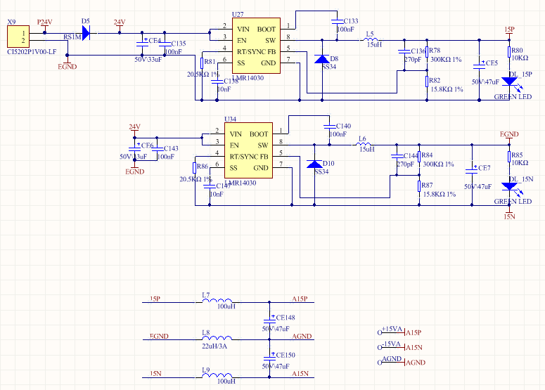

hello sir,
   one customer use two LMR14030 in their design, one si DV 24v to 15V, another is 24v to -15v, -15v is mark 15N, and 15V is mark 15P, in schmatic, which is for the AMP and ADC, and there are one L (L9)and C between 15N and AMP&ADC, they find one issue, if connect L9, 15N &15P is no output, if open L9 , 15N and 15P output is normal, if let the 15N and 15P power up, and then short L9, 15N and 15P output still can work. so we don't know what's reason happen it.
details pls refer related schematic
