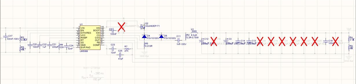

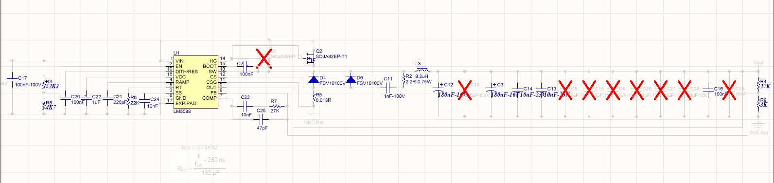

LM5088: In case of short circuit, the mosfet and output capacities are burning.
Part Number: LM5088
I am design a DC-DC converter. Now, i'm in the test phase.  There is a problem with the short circuit test. I am using SQJ82EP mosfet. In case of short circuit, the mosfet and output capacities are burning. How can i solve this problem?
The specs of design;
Vin = 15-60 V
Vout=12 V  Iout = 3 A (typ)
Mosfet = SQJA82EP  N-Channel 80 V (D-S) 175 °C MOSFET
Diode = FSV10100V  10A 100V  Ultra Low VF Schottky Rectifier
