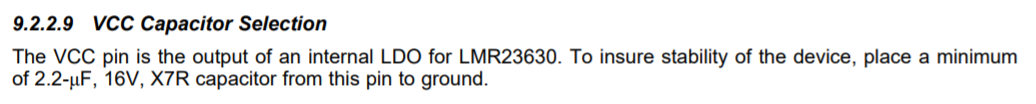

I have a question while reading LMR23630 datasheet.
(that about iternal LDO of LMR23630 for operting internal contorol block and fet driver.)
teaching to me on datasheet that "Place a high-quality ceramic capacitor with a value of 2.2 μF to 10 μF, 16 V or higher rated voltage as close as possible to VCC and grounded to the exposed PAD and ground pins"
but i want to use 6.5V MLCC.
it is possibel or impassible?
I want to know, why rating voltage of MLCC is 16V? (Input voltage is maximum 38.0V)
    We recommend a 16V capacitor due to capacitor's capacitance derating (decreasing in value) as ambient temperature increases, as well DC voltage applied. I would recommend using a X7R and a value in that range where you can fit into a smaller package, than say a 10uF, such that you place the VCC cap as close as possible to the converter.
    Hopefully this answers your question.

  • Sorry I was not clear in my last post, let me summarize my thoughts and then I will give you my suggestion.
    1. Capacitance decreases at elevated temperatures
    2. Capacitance decreases as applied DC voltage is increased
    We specify in the datasheet that we recommend at least a 2.2uF, 16V, X7R capacitor to ensure stability of the converter. Following this suggestion, you would ensure that your capacitor does not derate too much from its nominal value, as a higher DC voltage rating cap will derate less with a lower applied DC voltage (if your interested in me explaining further I have a few good resources that I can find for you).
    I can not recommend using a 6.3V capacitor as that disagrees with the datasheet. I recommend you choosing a 2.2uF, 16V capacitor
