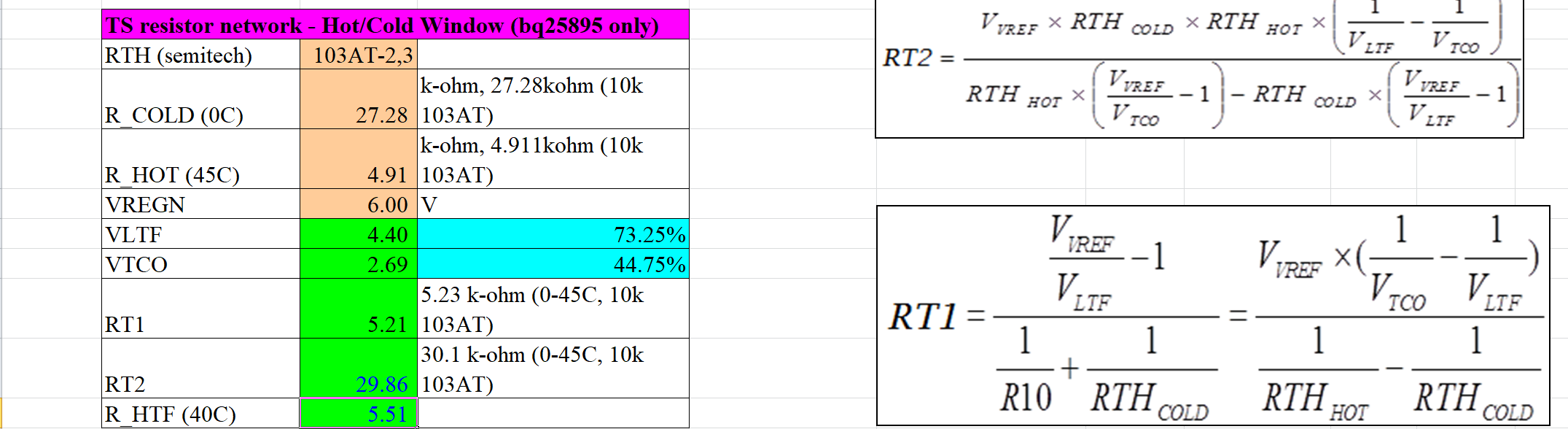

in the related post, you said VT1 and VT5 are VLTF and VHTF.
But in the excel downloaded from the link you provided, it's VLTF and VTCO.
I wonder which one is correct.
Jeff,
I've told the customer that VT5=VHTF according to the related post.
What bad effect will it cause?
