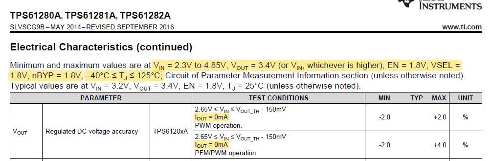

I would like to ask, TPS61282A's output tolerance, spec marked -2%~4% in auto mode
1. Is this tolerance suitable for use at a temperature of -40 to 85 degrees?
2. Is the -2% to 4% tolerance applicable to DC pumping with hypothesis 2A?

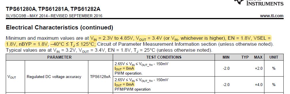

     Output accuracy spec is  -2%~4%, test condition is -40 to 125degrees. Iout=0mA. Please see my highlight part.

    Spec is marked with a number of pieces of verification data, but when a large number of times, so the output of the IC is keep -2% of the tolerance, and is it also -2% at -40 to 85?
    Kami Huang
  • Hi Kami,
    EC table: Output accuracy spec is -2%~4%, test condition is -40 to 125degrees. if your working condition is -40 to 85, we can guarantee Output accuracy spec is -2%~4%.
