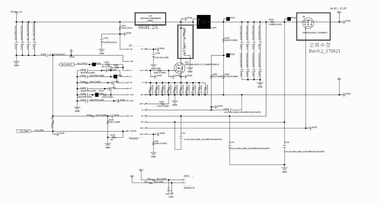

Hi team
I was designed below.
My schematic produced three defects. (total 20)
Could you check the schematic?

  • Hi Tuan
    The device is hot.
    And it does not work.
    I asked TI Korea for a failure analysis, but there was no problem.
    The schematic looks fine. Please tell us the suspicious part.

  • Hi TM,
    We would like some information and scope capture in order to help you on this.  Can you give me the output current that you want to command with the 46V-53V LED's voltage?  Is the TPS92692 getting hot or is it Q10 getting hot?  We noticed that R281 is 100 Ohm resistor...This is quite high resistance please try with a 0 Ohm short for now.  How did they arrive at the compensation components, R285 at 10K?  Again this is high.
    Can we get scope captures of the below signals:
    CHAN 1:  LED output current   CHAN 2: Voltage on the Gate of Q10
    With timebase of 2mS/div then 2uS/div.
    Thanks Tuan
