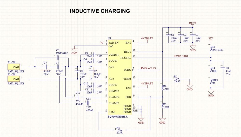

I'm using the BG51050 receiver with a Vishay IWAS3827ECEB100J50 receive coil.  Using the equations for the inductor coil tuning caps I calculated 237nF in line and 2.39nF across AC1/2.  I used 2x470nF in series to create 235nF, and 2.2nF and 180pF in parrallel to create 2.38nF.
The bit of my maths I'm not sure of is the use of 10.7uH for both Ls' and Ls, but this is the only datasheet value for the coil.  Also this is the 200kHz value not 100kHz.
That said, I don't think this is the issue. Vrect is reaching 5-6V.  Very occasionally I get the output working for 5-10 seconds (I'm monitoring my battery current draw between it powering the very low current of the system, and its charge current), but generally not at all.  There are comms with the transmitter, but the transmitter generally falls into fault mode.
Could this be an Rfod related issue?  I'm currently testing with 2 COTs charging pucks (Samsung EP-PG920I, and a Belkin F8M747V2).  The TI Tx chips all look to be NRND, are there replacements in line? Is there a Tx eval board which has debug outputs which will give more feedback that could help point me in the right direction to find the cause of my issues?

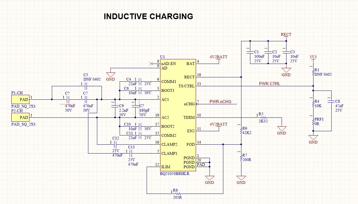

This is the schematic as it stands:
  • Hello Pete T
    A couple of things to try, I suspect TX is tripping off due to FOD.
    1.) Increase power reported by RX to add more FOD margin, increase R-FOD (R7) from 200 to 300 and decrease ILIM (R8) from 200 to 100.
    2.) Remove R6, not needed at this point
    3.) Reduce loss on input by changing from 2X470nF to parallel capacitors for 235nF. Recommend using X7R for caps, COG / NPO would work also.
