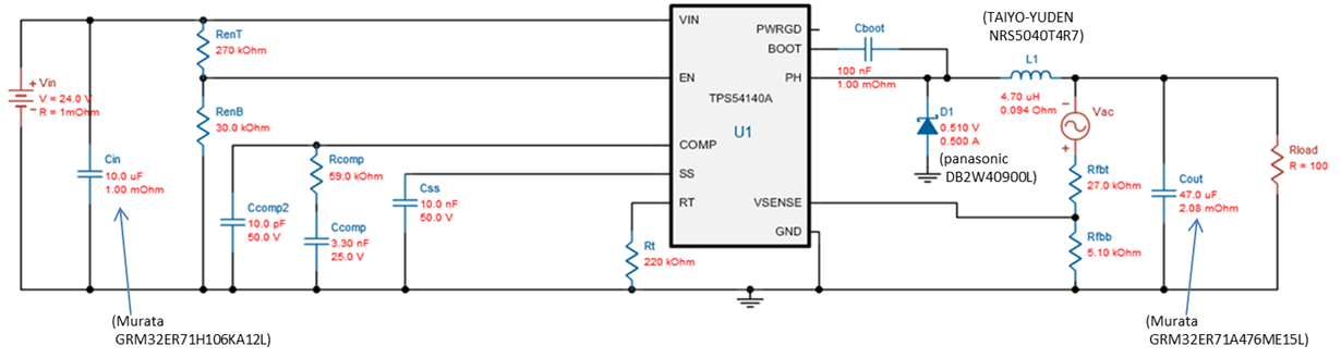

TPS54140A: Vout Ripple in case of a small Load (pulse skip mode)
Part Number: TPS54140A
To reduce a ripple of TPS54140A in very small load (~less than 50mA) situation, I will choice a low inductance value(4.7uH). Is that OK ?
The inductance value calculated by the equation of Lo(min)(in 8.2.2.2 Output Inductor Selection (Lo)) is large (in case of lower Iout). But in case of pulse skip mode, this equation is not appropriate. Is that correct ?
If there's some advice about the capture shown below, Please let me know the point exactly. It would be great helpful.
