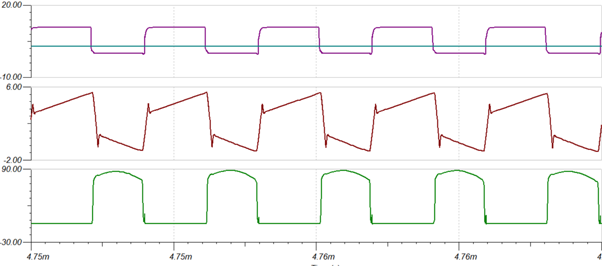

I found the UCC2897A EVM simulation file. There is not soft-switching appearance on the main MOSFET.
The VDS & IDS on Q2 are crossovered.

I must have changed something else with the file when I changed the RDEL resistor to 30K as I didn't get ZVS when I only made that change this time. I re ran the sims a couple of times and tuned the transformer by reducing the Lm to 40uH and leaving RDEL at 8.5k.
I change Lm to 40uH and Lk to 1uH. In the real application Lm will have to be adjusted along with RDEL to optimize the ZVS performance of the design.
