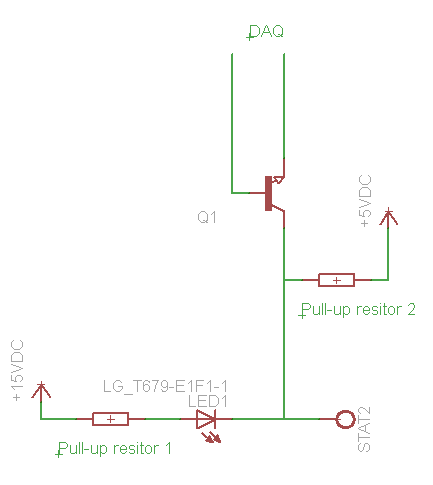

I also have another question. While I was charging a battery that had very low charge (6 V) both of the status leds (STAT1 and STAT2) and the power led (PG) were on. I didn't find a state for this kind of status from the manuals table 3. What does this indicate?

    I don't think STAT1, STAT2 and PG should be on together. I think some pins are blinking. It is very important clue. Please use sope to check which pin is blinking.

    Only two leds (STAT1 and PG) are on now and either of them doesn't blink. Thou there is a small spike in both every 3 microsecond. The third led (STAT2) seemed not to be as bright as the others, but I can't recreate this state so I cant measure if it is blinking or not.
  • Hi again
    I found out why the third led was lighted. I have a transistor that lets the DAQ know what status leds are on. There is a pull-up resistor for the transistor and it is pulled to +5V while the led is connected to +15V. The transistors are on a differend PCB so I will put some diods between the boards. that should fix the led problem.

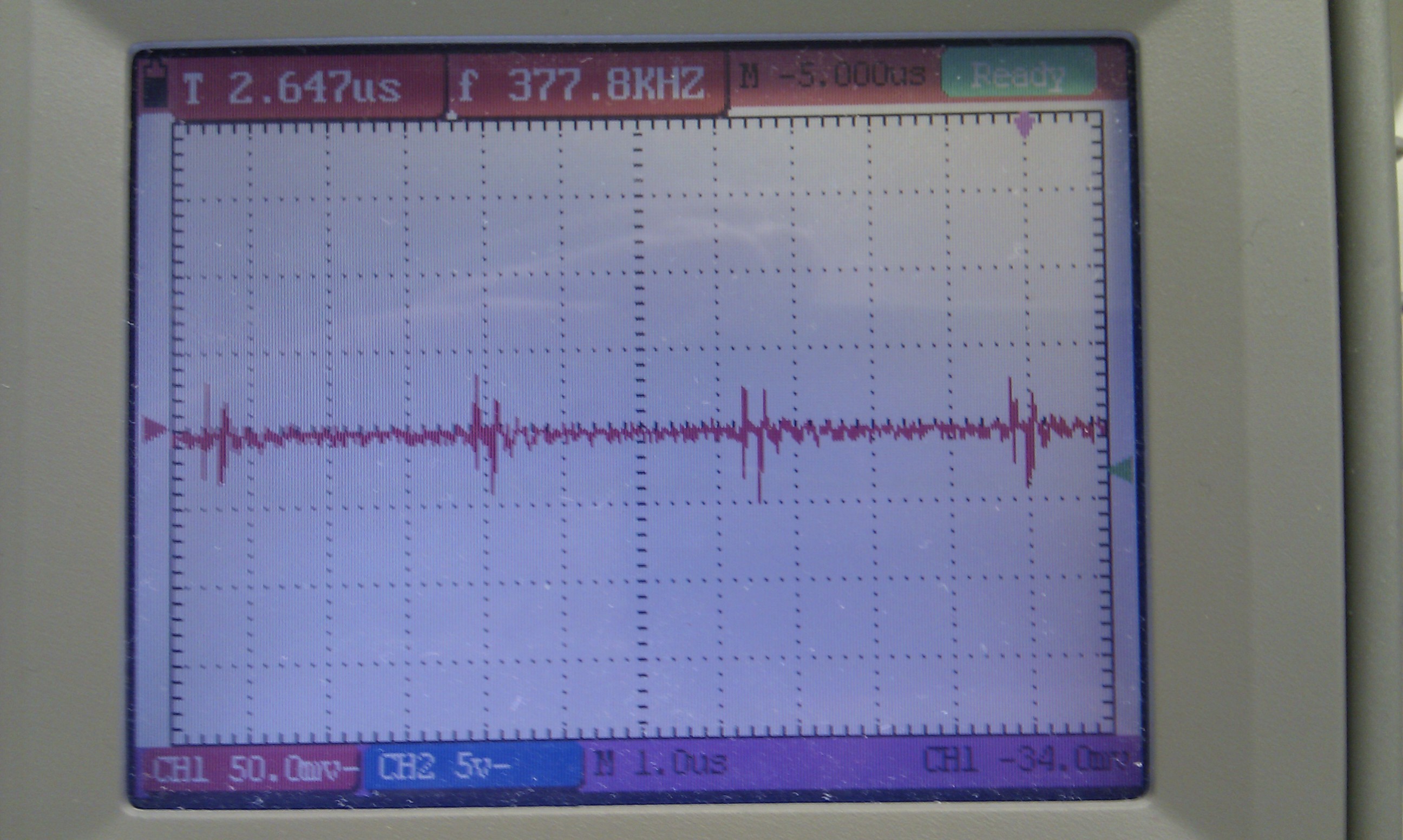

  • If STAT1 is on, it indicates "Charge in progress". Would you hlep me measure the Vsrp-srn and Vacp-acn?
    In normal temperature range, the bq24630 should regulate the charge current at setting value. If the sense resistor has problem, it can cause a lower current.
  • Hi
    There does not seem to be any voltage difference between SRP-SRN or ACN-ACP.
    Vsrp-srn Vacp-acn
    Although there seems to be very small pulses between the pins (0.4V and 0.1V).
    Mikko

  • From the schematic I did not see any obvious problem except that the PGND and AGND are not separated (check the EVM and d/s for design and layout reference). Although I can not open the Gerber file to check the detail, I know some similar problems happened on other customer's application.
    1) Please verify the resistor R3/R8 are good, still 0.01Ohm.
    2) Please measure the voltage across R3 and R8 and that voltage directly at ACP-ACN and SRP-SRN pins of IC. Because the ground is not separate, noise will be introduced to the current sensing loop (note normally this voltage is 10mV level). C5/C10 ground is AGND and all C5/C10/C4/C7 need to be placed as close as possible to IC pin.
    3) check the VCC_BAT voltage to make sure the IC is powered (R4 is not burned), check the REF and REGN to make sure the LDOs work. Check TS/ISET/ACSET voltage make sure the resistors are installed right.
    4) check the SYSTEM voltage to make sure input FETs are ON and buck converter has input.
    5) check the PH/BTST/HIDRV/LODRV waveforms to make sure the converter is switching.
    6) check the VFB voltage (this sensing loop also sensitive to noise, check the EVM for layout). It's should be 1.8V at voltage regulation.
    If you still can not fix the problem. Call us and ship your board to us to check it.
