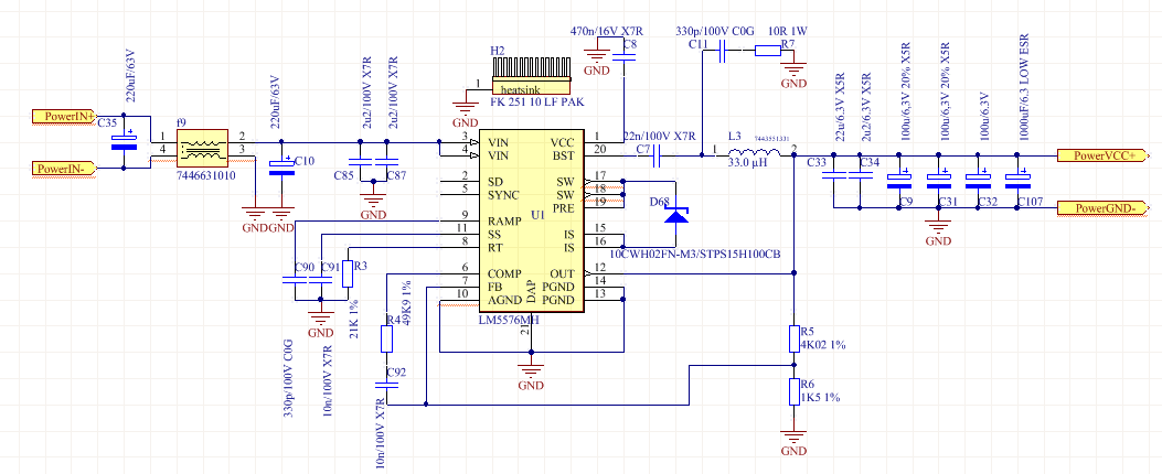

Hi Team,
continuing https://e2e.ti.com/support/power-management/f/196/t/709097 - the LM5576MH is still getting damaged in our design.
This happens probably when voltage is being turned on. Below is the schematic.
Can you please help us solving the issue?
Thank you,
TI Customer
  • Hi Bartosz,
    What is the applied input voltage? Also, is it possible to capture the waveforms of the event that causes damage during startup?
    As mentioned previously, it's critical to locate the input ceramic cap close to VIN and PGND of the IC.
    Tim
  • Hi Tim,
    the input voltage is 60VDC -68VDC.
    It's not possible to capture the waveforms, because the damage happens in 10% -15% of all devices / finished products brought back from the field.
    Staff reports that on first switch-on the device doesn't work.
    On one board we have LM5576MH, LM5017MR/NOPB plus LM5010AMHE/NOPB.
    The DC/DC are supplied with 50-60 VDC. Each one is separated with 7446631010 filter. We use PLC communication between devices - communication over power.
    Maybe it is important that LM5576MH are used for powering led matrix. Led matrix are multiplexed. It means that for some time (us/ms) DC/DC have no lead.
    Regarding location of the input ceramic cap close to VIN and PGND of the IC -> Is 3 mm distance too long ? We have two ceramic capacitors 2x 2u2 /100 V X7R.
    Thanks for your feedback and help.
    TI Customer
  • Hi Bartosz,
    Please check input filter damping in case the input voltage overshoots during startup. I will follow up directly by email.
