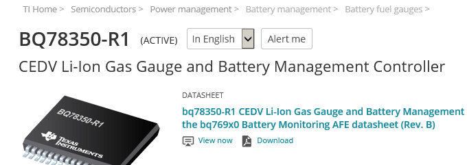

  • Hi Larry,
    If you have a My TI account you can sign up for "alerts" with the "Alert me" button next to the product name in the product folder on the web.  The document update produced a mention in an end of week email like this:
    Product Part Number: BQ78350-R1
