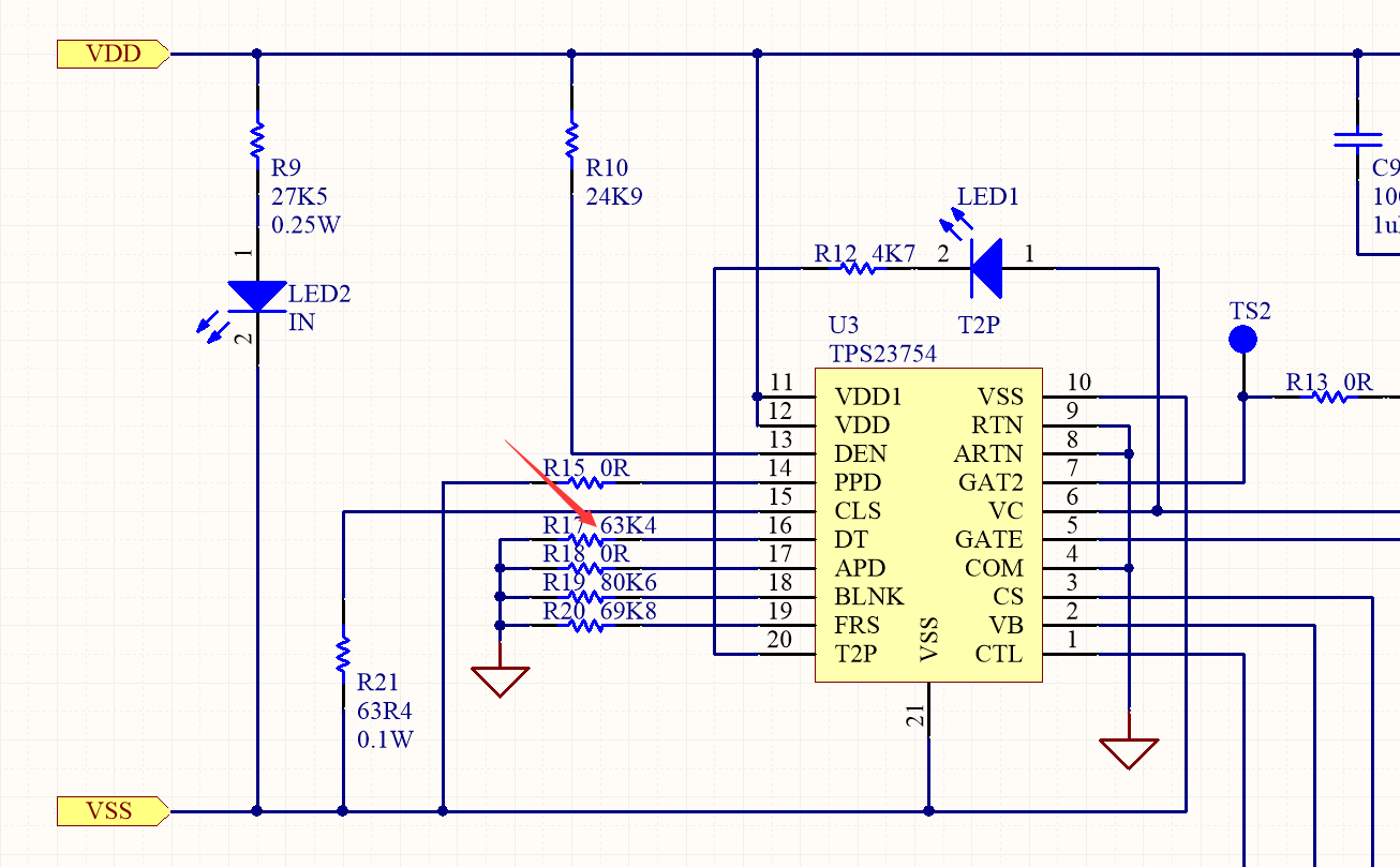

  • Hi ikon,

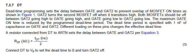

    You are currently set for 1260 nanoseconds of deadtime. During this period, the full output current is conducting through the body diodes of the secondary FETs, so they are getting very hot. I suggested reducing your deadtime to 150nsec. You can try even 50nsec, but you may need the additional deadtime to reduce the likelyhood of shoot through, which is more common at 24V.

  • Hi Tom,

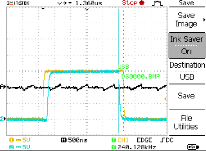

    According to the TPS23754 datasheet, my designed deadtime is 126.8 nanosecond.
    From my measurements, the deadtime is roughly 140ns, which is close to the design.

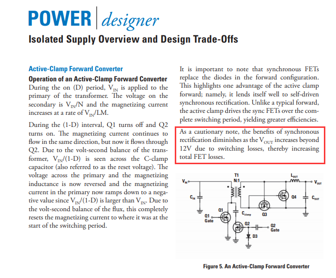

    Besides, recently I read an article from TI, http://www.ti.com/lit/an/snva603/snva603.pdf
    Seem like active-clamp forward converter is not suitable for my design (24V @1.25A).
    I might consider change solution to flyback.

  • Ikon,
    Regarding the deadtime: you are correct. Thank you for the correction.
