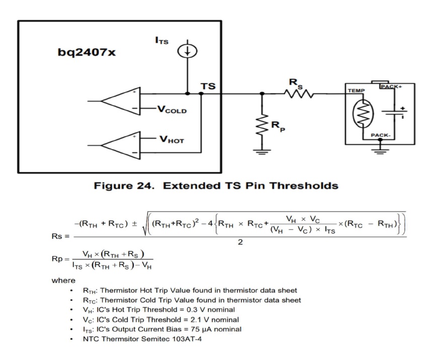

According to 9.3.6 Battery Pack Temperature Monitoring.
The allowed temperature range for 103AT-2 type thermistor is 0°C to 50°C.
I have one question about this.
Colud i decrease the temperature range to  0°C to 45°C.by adding two external resistors?
