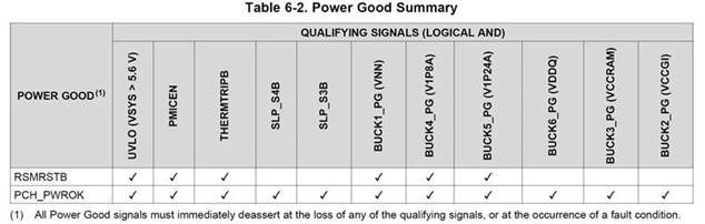

Would you please kindly help to let us know what is the criteria which causes PCH_PWROK/RSMRST turn low? Thanks a lot!

Ann,
These signals will only go low when one of these qualifying signals goes low.
