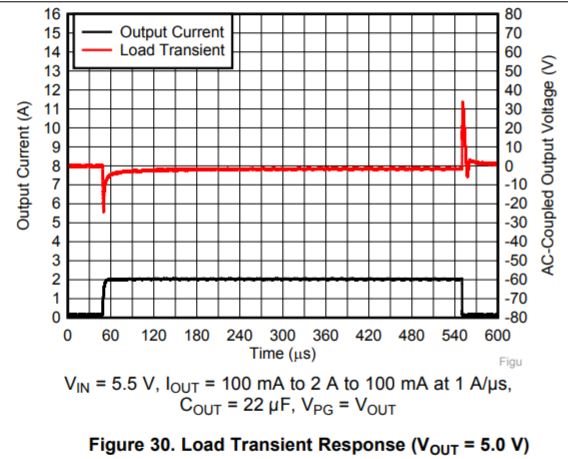

Hi Team,
Customer is using ADM7172 in their project. Do we have any parts that could replace it? I have checked our new parts TPS7A92 and TPS7A83, seems don't have as fast response as ADM7172.
The input voltage is 3.3V to 4.2V, output is 3V. Customer care most about the fast transient response, and also high PSRR. Could you give some recommendation?
