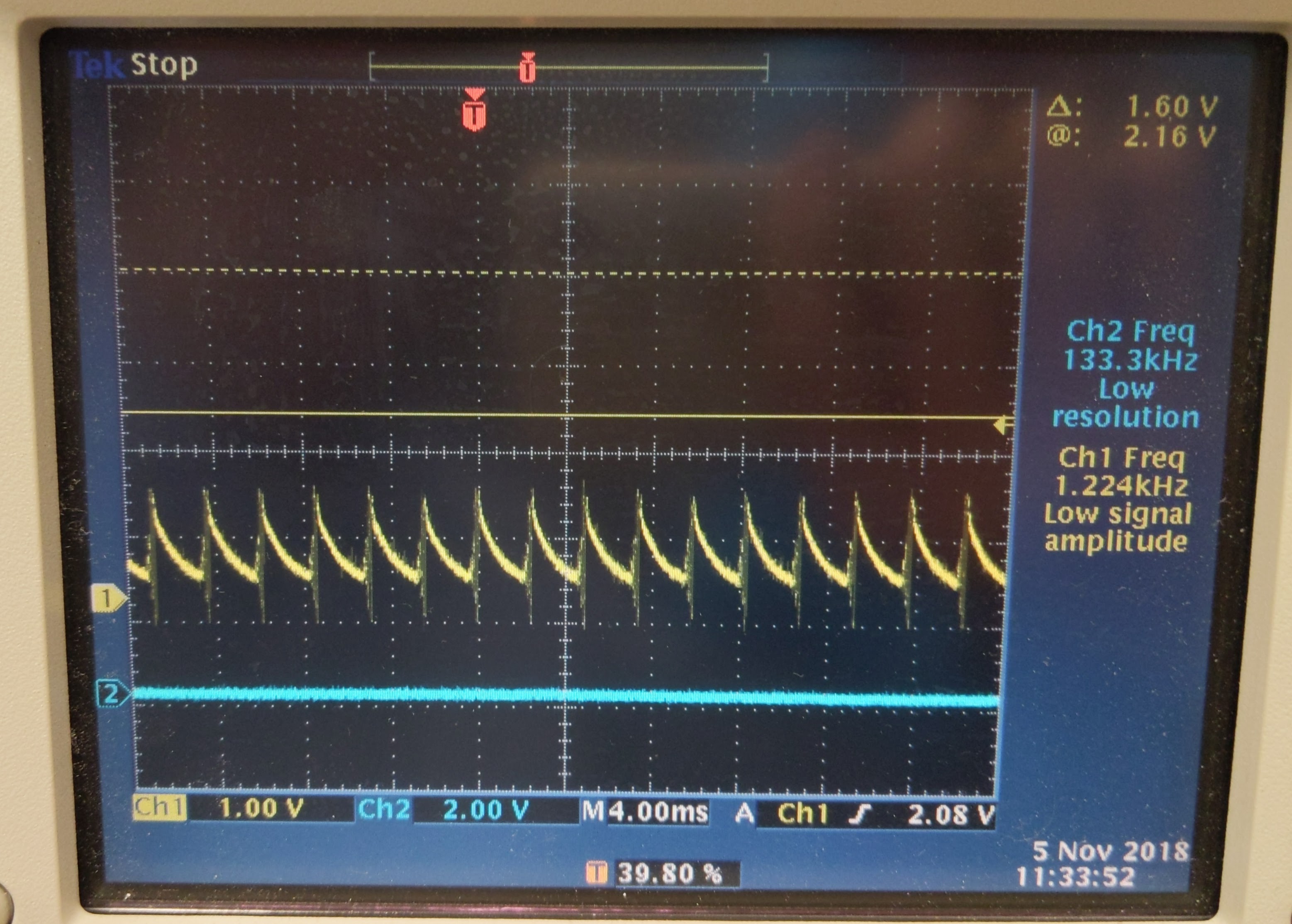

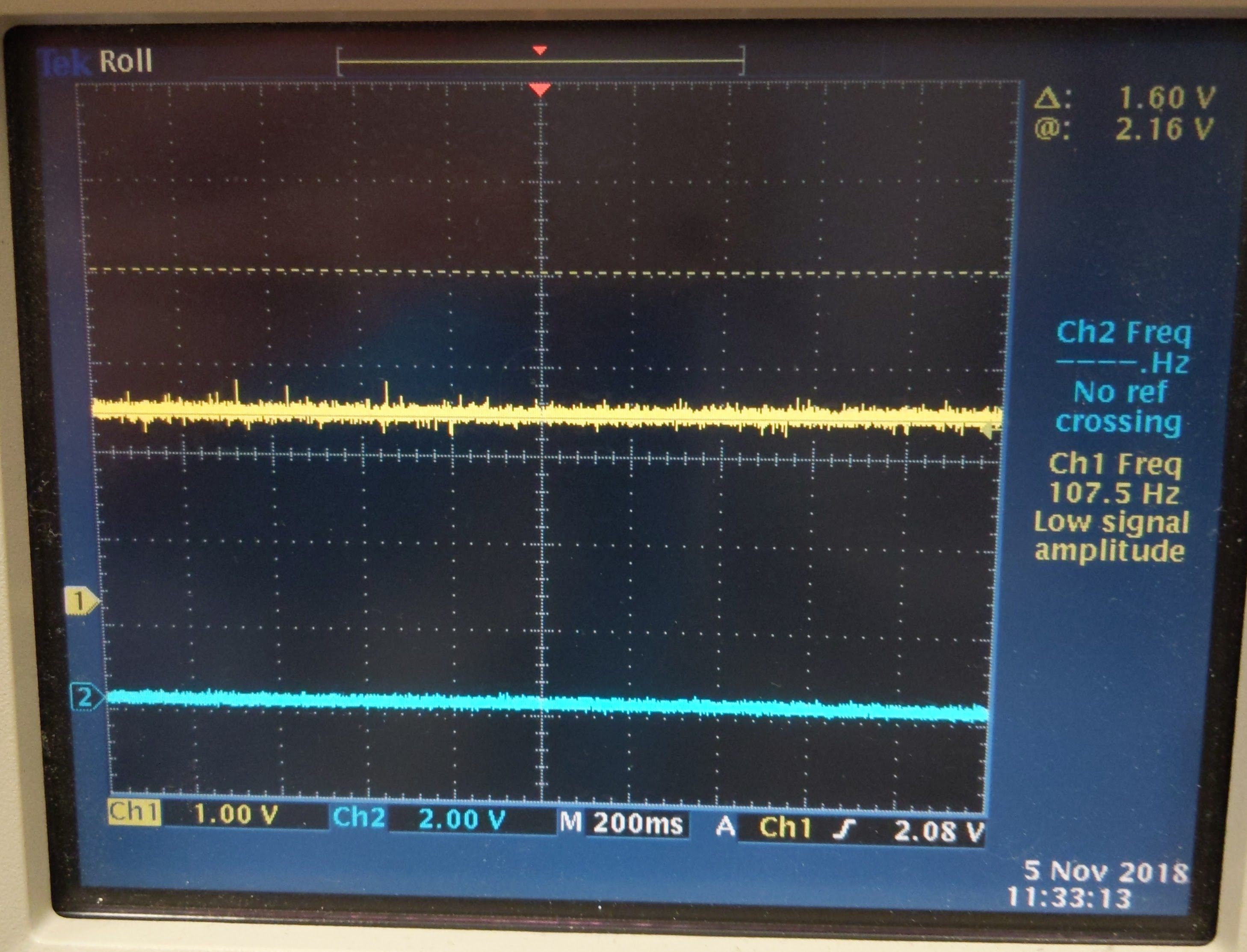

When bringing up the circuit we saw our designed 2.1V with a power good signal.  I probed the output with a oscilloscope and the result is below (output_1.jpg) where channel 1 is the output.

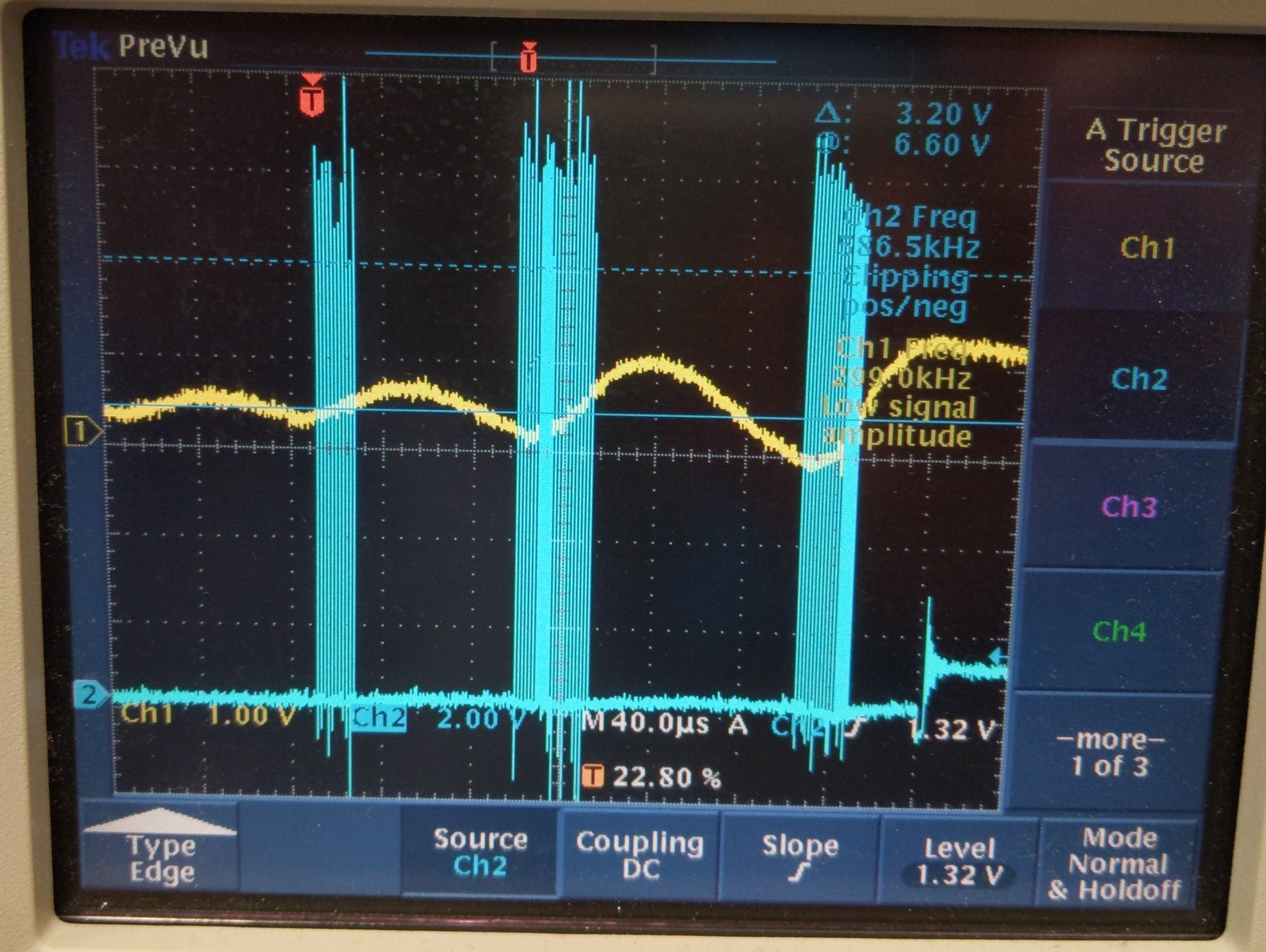

Then I applied a 1 ohm load to see how the output would change.  The result (output_load_1.jpg) shows that the LM27402 went into some sort of hiccup mode of periods of switching and rest.
Further zooming of the signal (output_load_2.jpg) shows that when the buck converter stops switching (where channel 2 is the signal seen on the SW pin), the low side MOSFET is turned off, indicative of an overcurrent event as demonstrated in the datasheet Figure 25.
The issue is that when calculating what our current limit should be, I get around 17.5A using equation 13 from the datasheet.
One issue I thought of is that the time constants with the DCR of the inductor and the RC filter are not matched.  Using the 3.43mohm DCR of our inductor, we should be using a 901 ohm resistor for R_S using equation 12 in the datasheet.  I am using 845ohms.  Could R_S really be that sensitive?

    Couple of clarifications. How many input caps of 22uF are you using? You need to use atleast 3 nos.
    Also the output caps are too small. You need atleast 100uF output cap. I would recommend changing the compensation as per attached spreadsheet with 100uF output cap and then check. One theory is that you are having too much overshoot and the part is hitting negative current limit at LS fet after OVP.
    Check points:
    Vin:  (to check ripple voltage and make sure the input filter inductor is not causing any oscillations
    VDD:  (You are taking around 50mA from Vdd for driving these fets at 600kHz so want to make sure the Vdd voltage is not going to current limit etc.)
    Vsw: take switch waveforms at no load just to make sure there is no big ringing causing the SW pin voltage rating to be exceeded
    Input power supply current limit setting check
    Mathew
