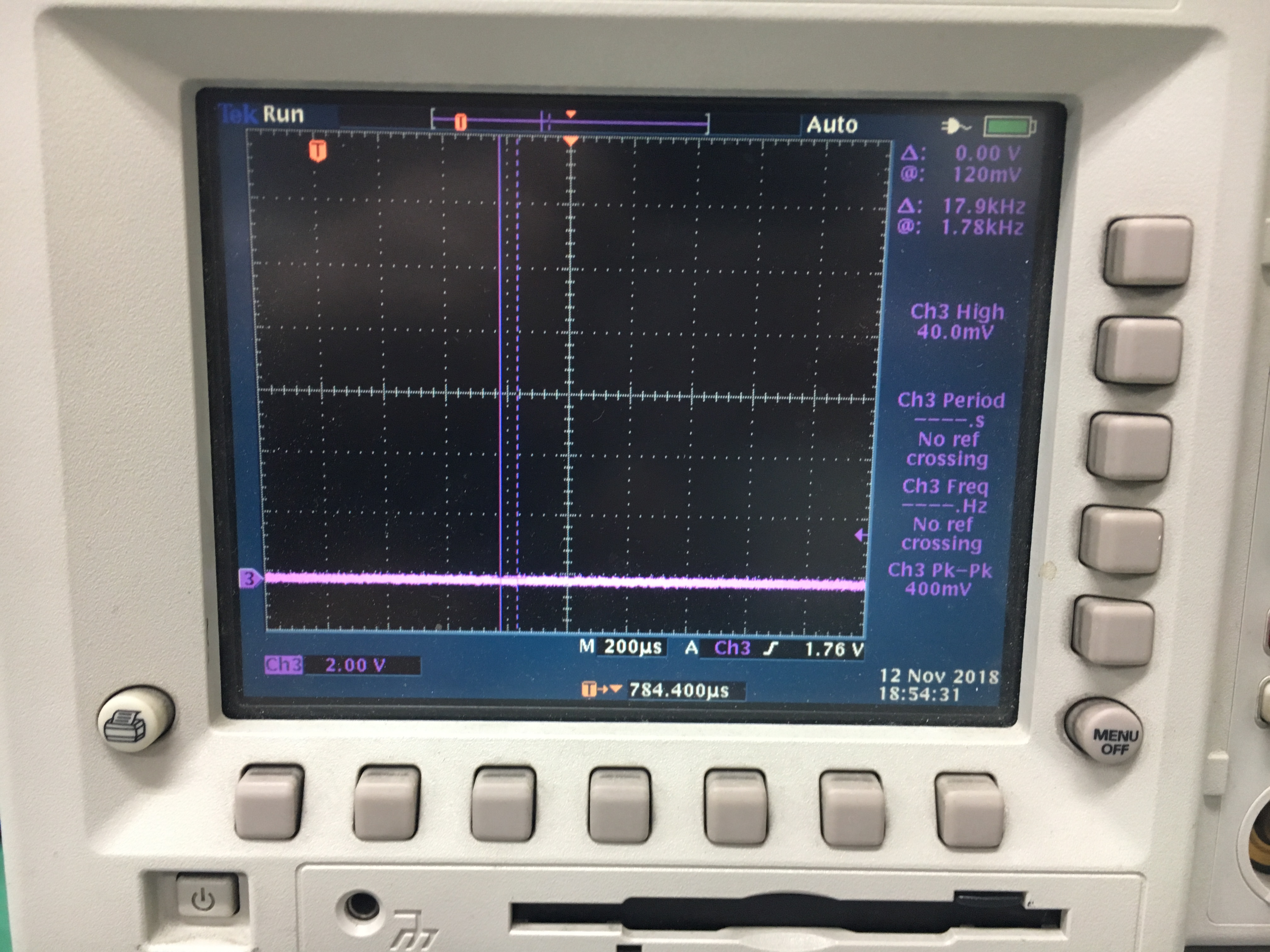

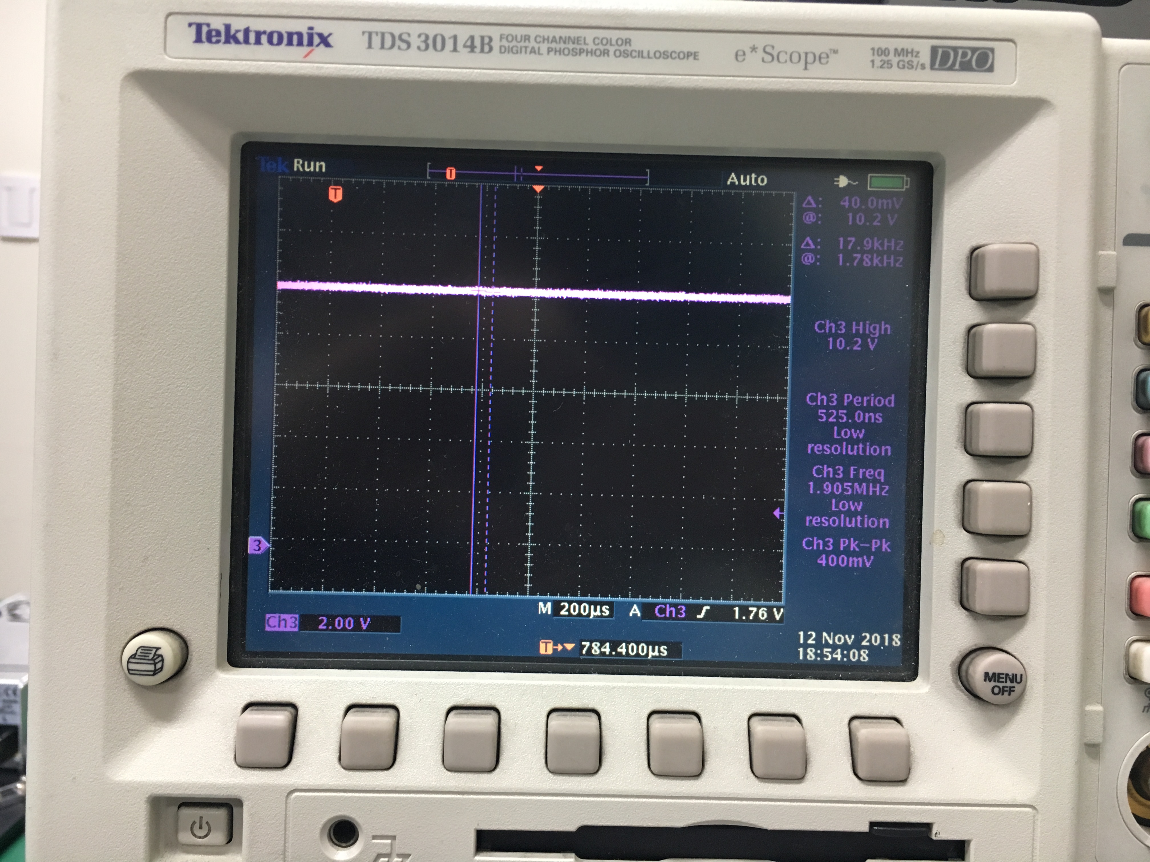

    Can you share the waveform for VIN, VOUT, FLTb and IMON pin with overload condition (I > 680mA)?
  • Hello, Lokesh
    Thank you for your Reply.
    My MODE pin is connected to RTN pin using 402k resistor.
    And my device is TPS26600.
      VIN
      VOUT
      FLTb
      IMON
    If Mode pin is open then operate auto-retry.
    However, using a 402k resistor does not work with latch-off.
    I don't understand this situation.
    Please reply to me.
    Thank you.
    It looks there is a difference of 1V between VIN and VOUT (11.2 - 10.2V) and FLTb pin is low. It means that the device has already turned off the internal FETs due to UVLO, OVP or Overload. You can try increasing the input voltage to 13V, so that the device does not go into UVLO.
