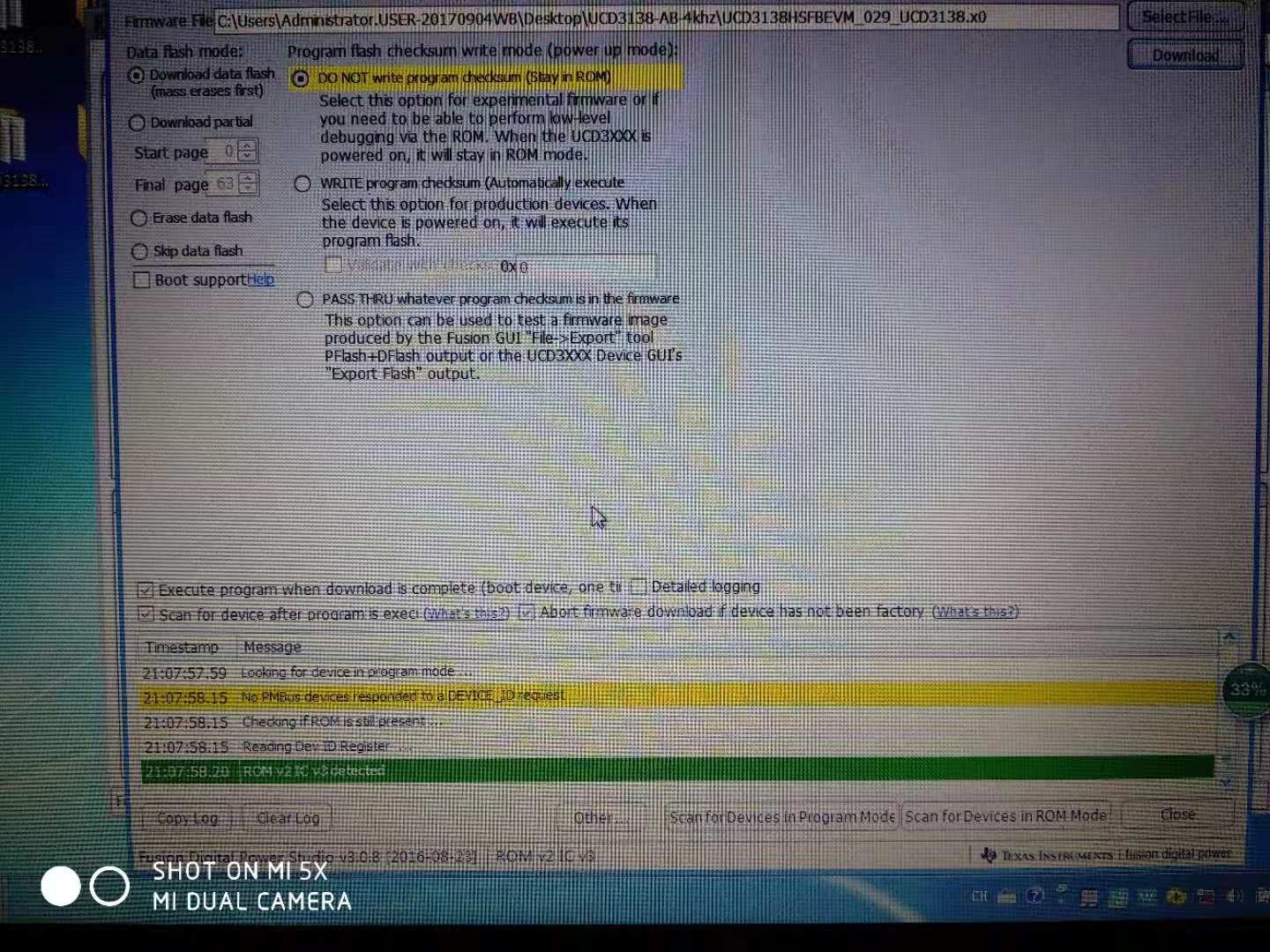

I changed the output capacitance of the prototype and reported an error when burning the firmware again. As shown below:
The program displays "No devices found".
I changed the second prototype and it can burn and work normally.
I don't know why it failed when burning. Why can a prototype burn  successfully but another  prototype  fail to burn? Is the UCD3138 of the failed prototype broken?
  • I tried to re-burn the firmware, but still reported an error, as shown above.
    "No PMBus devices responded to a DEVICE_ID requset"

  • Please scan the device in ROM mode (Click on Scan Device in ROM, on the top side of device GUI)
    Based on your screen shot I can see that you have chosen not wrote the checksum.
    So your device may be in ROM mode.
  • In the first picture, I first clicked on "scan the device in ROM mode". When the status is normal, it shows "Found ROM V2 IC V3-UCD3138.Rev2". When I click "command rom to execute its programe", it appears. The error was "no device found".
