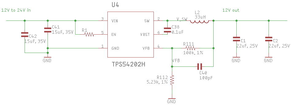

TPS54202H: ENable input pull down resistance.
Part Number: TPS54202H
When I put together a test circuit using the recommended 510k ohm pull up on the enable input, the regulator wouldn't turn on. I measured the resistance to ground at the enable pin and it measured about 14k ohms, rather than the 1 Meg typical specified in the data sheet . Based on that measurement I used a 24k ohm pullup to VIN, and the regulator turned on and worked properly. Is the data sheet value for the pull down wrong, or is my device defective?
