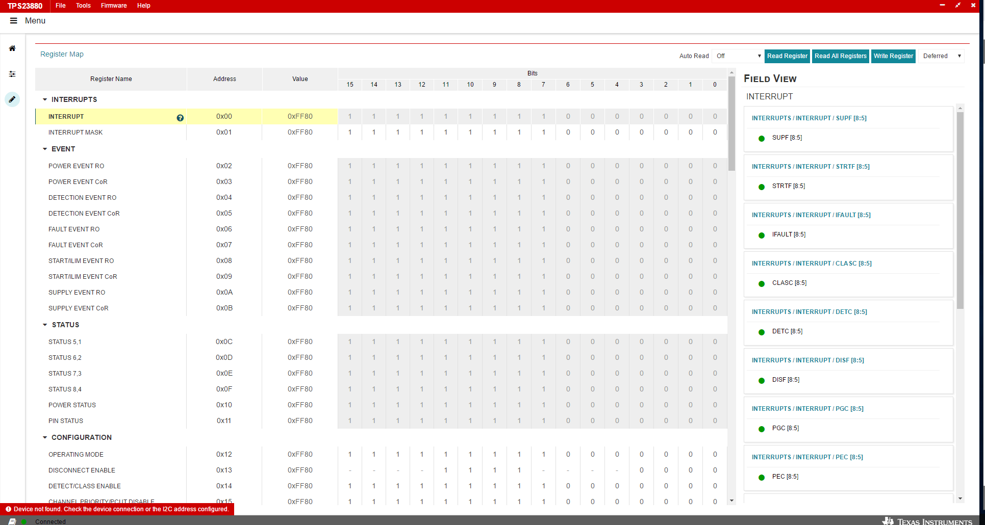

TPS23880EVM-008 to the micro controller  through  SCL,SDA  ,3.3 ,GND (J2 connector).
Problem I am facing
1) After power up when I read any register get receive 0x80.
2) Some time even if if set the configuration still chip does not do class detection
 Below my steps
 From register map
  1) Set semi auto mode
  2) Set 2pair ports in 2 pair 15.4 w mode
  3) Enable all channel's DC disconnect
  4) Enable Detect/Class enable
I have also down loaded the SRAM  still does not have any effect.(This code I copied from the sample code given ).

If I configure TPS23880EVM  with TPS23880GUI then connect to the micro controller(without power off) then it works. I can read the register values properly.
Could you describe initial  steps to configure the device after power up.

  • Hi Joji,
    From the you GUI screenshot, the GUI lost communication with the device(it says deice not found). I don't recommend you connect MSP430 and GUI at the same time. You will need to disconnect MSP430 board and reopen the GUI. Thanks.

  • Hi Joji,
    I don't think this is a device issue. Probably something is unstable with the GUI. Were you able to solve this problem by reopening the GUI? When I ran the GUI and sometimes I saw the GUI didn't update the status. Probably a good way to separate the problem is: connect a PD to the port and see if the GUI update the detection and classification results. Thanks.
