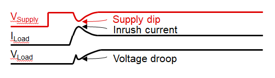

    We recommend maintaining a 10:1 ratio between input capacitance and output/load capacitance. While this is inherently not a problem, there are two potential concerns to think about when COUT > CIN:
    1. Normally, the CIN capacitor is used to help the power supply handle large amounts of inrush current. During startup, if CIN isn’t large enough, the sudden change in current can cause the input voltage to sag.
    2:    If VIN suddenly drops while the device is enabled, there could be a brief moment where VOUT > VIN. If this happens, this could potentially bias the body diode inside the device and cause reverse current to flow upstream. Will there be a condition where VIN could suddenly be removed while the device remains enabled?
    If you don't see either case being an issue, then you could reduce CIN. Keeping it at the same value as COUT should be acceptable, so 10uF on the input should work.
