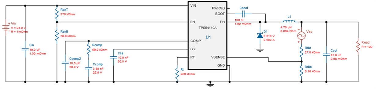

I have a ripple problem with TPS54140A in very small load (<50mA).
The ripple wavefroms are (1) shown below.
So I selected a low inductance to reduce the ripple.

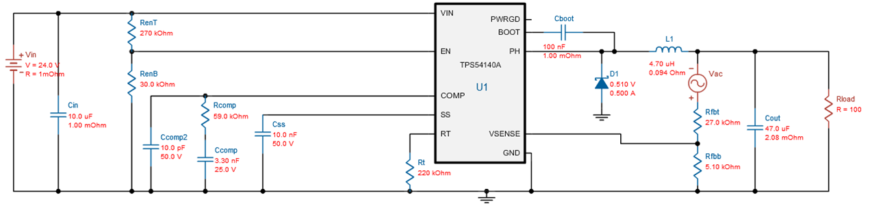

(2) is the circuit diagram, and (3) shows the waveforms(IL and Vout) captured from this circuit.
I wonder the circuit (2) is a correct solution for a very small load application.
If there's a problem or an advice, Please let me know. It would be very helpful.

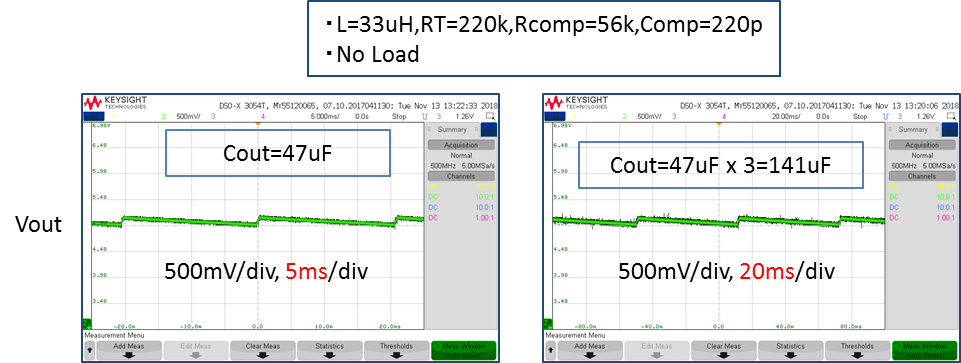

(1) Comparison of different inductance value (when no load attached)
(2) Circuit

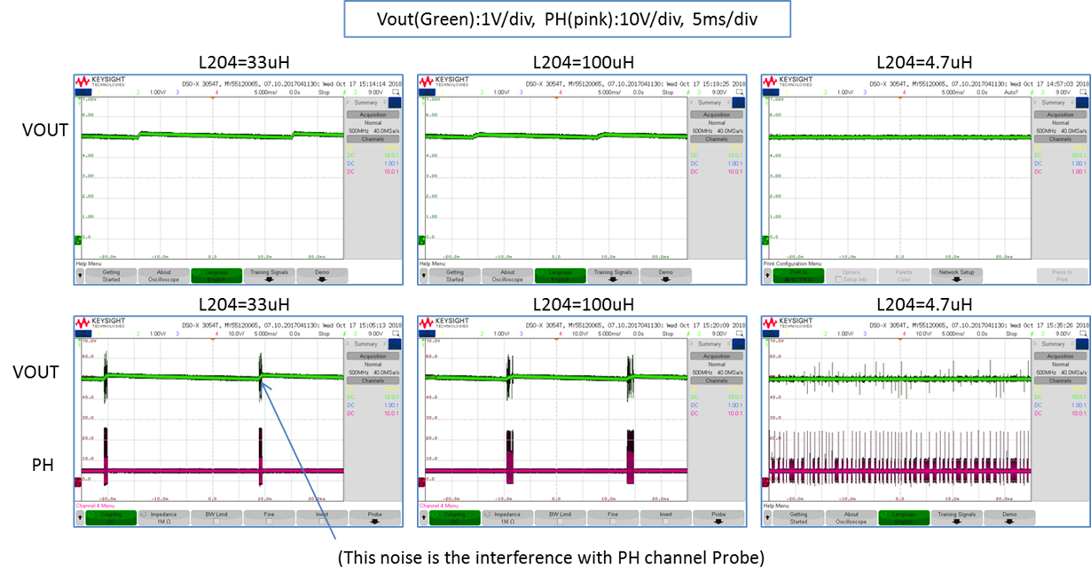

(3) Comparison of different Loads with inductance=4.7uH (above circuit diagram)
    I forwarded your enquiry to the product expert. In the meantime, I took a look at the schematic and noted that this is a 1.5A converter. Thus, it runs in DCM ("pulse skip ECO mode" as described in the datasheet) at light loads.
    What is your output voltage ripple spec?
    Tim

    ±5% is desirable.
  • Increasing the output cap reduces the voltage ripple increase related to the triangular inductor current pulses at light load. Using a higher inductance also helps.
    Tim
  • >Using a higher inductance also helps.
    According to the waveforms in the [ (1) Comparison of different inductance value (when no load attached) ], the smallest inductance case gives the best result.
  • That may be correct - the energy per pulse (0.5*L*I^2) is increased if the inductance is higher.
    Have you tried increasing Cout? This should reduce the output voltage ripple amplitude (i.e. for a given packet of energy supplied to the output cap via the inductor).
  • >Have you tried increasing Cout?
    Here's the comparison of different value of Cout.
    The difference is cycle time of ripple waveform.

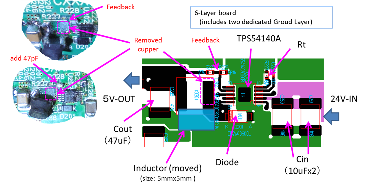

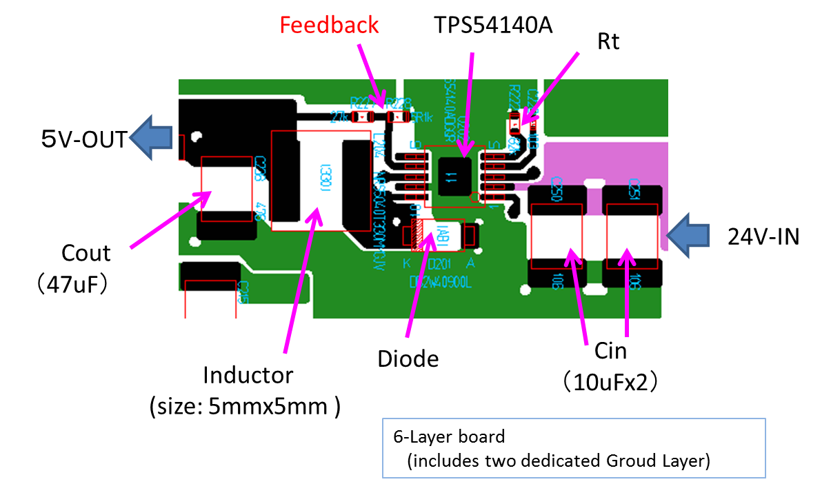

  • Looks like you're getting a lot of switching pulses when the IC comes out of sleep mode. Can you send the layout for review? In particular, the FB resistor placement and FB trace length are important as these are factors in how well the FB voltage tracks VOUT.
    Here's the layout. I think the feedback line is not so bad.
  • The feedback trace is too close to the inductor and is likely picking up noise from the high-voltage slew rates of the SW node. A small cap from FB to GND may help (47pF). Otherise, I recommned a layout change to resolve the issue.
    Tim

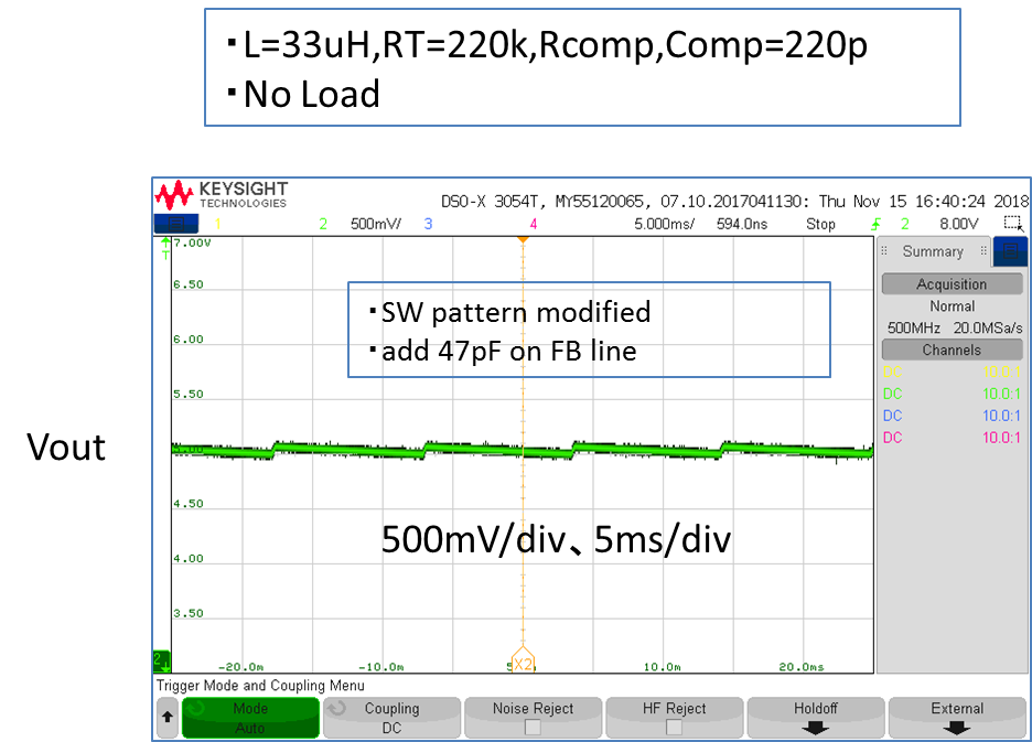

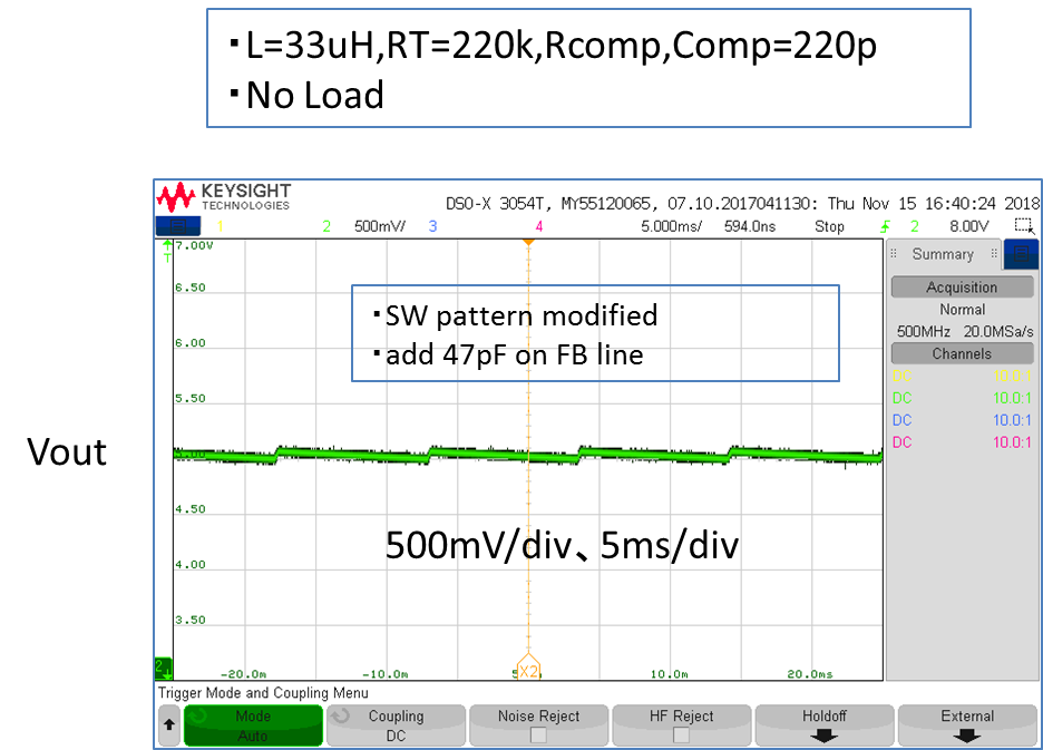

    I added 47pF on FB. but I think its waveform is almost same as previous one.This waveform comparison is shown below.
    I moved the inductance a little(~5mm) to prevent the interference with FB line. But its waveform is almost same.
  • Not sure if moving the inductor will help as the SW copper is still adjacent to the FB components and trace. I suspect the noise coupled to FB from SW is causing additional pulses when the converter starts to switch, thus increasing the output ripple.
    Tim
  • Thank you for your advice.
    I modified the board to remove the SW copper adjacent to the FB components.
    But the ripple still exists.
  • THe peak to peak ripple that you are seeing is little higher than expected .  Here is the waveform of 3.3V output at light load taken from TPS54140 EVM .
    Basically , When the COMP pin lowers to 500 mV typical, the device enters Eco-mode operation(pulse Skip).When the lower inductance is used , the device is out
    of pulse skip mode at much lower current due to higher peak current (which results in higher comp value) .
    ---Ambreesh

  • 1) TPS54160 and TPS54160A should have samilar output ripple perfromance . There is just Enable threshold improvement in the A version .
    2) I simulated the design and the closed loop performance looks OK
    What is the output load current you are designing for ? If you are designing for low current application , you can use lower inductance value and that way the device will come out of ECO mode at much lower output current . Hence your implementation with 4.7uH inductance should work well .

    > you can use lower inductance value and that way the device will come out of ECO mode at much lower output current . Hence your implementation with 4.7uH inductance should work well.
    Thank you for your confirmation.
