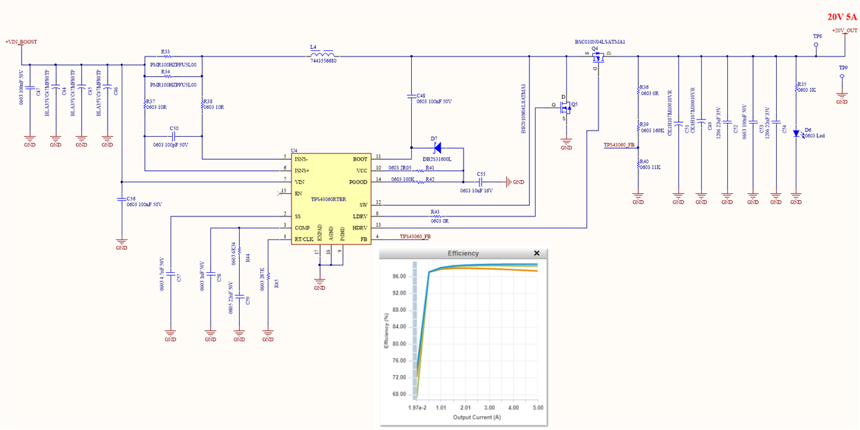

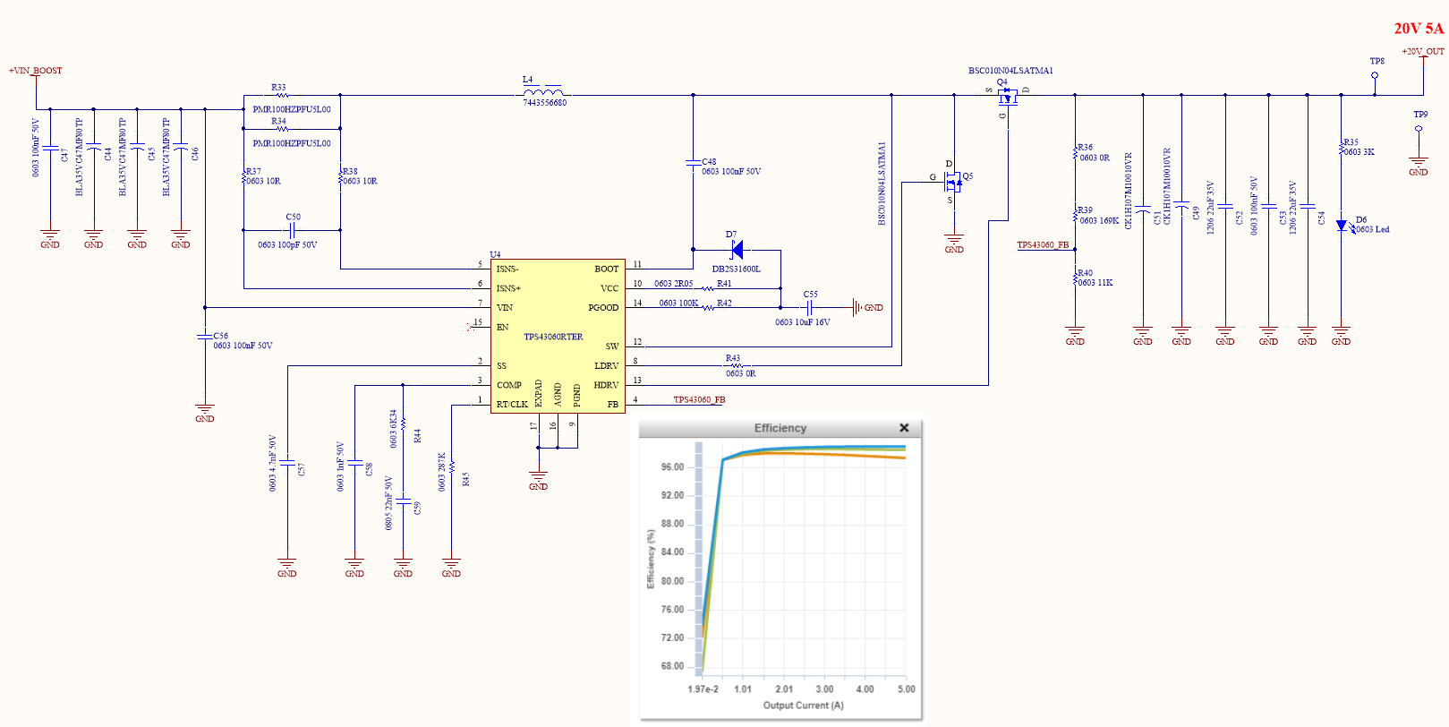

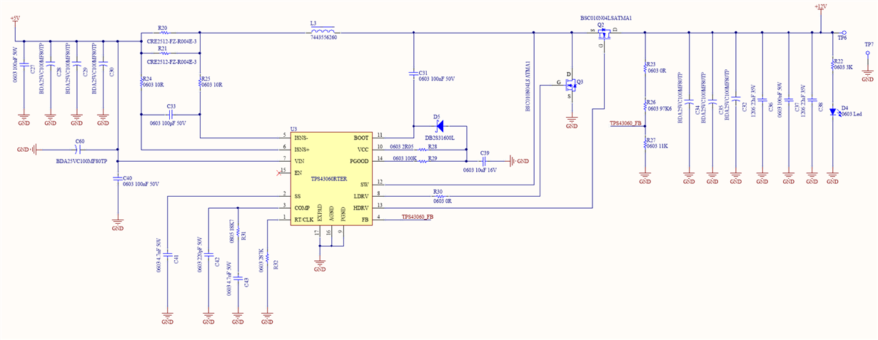

  • Hi again,
    Thanks for fast replay.
    I attached my 2 schematic.
    Based on TPS43060 i am making two design one is 4.5V - 5V to 12V 6A and other one 9V - 18V to 20V 5A. Both design 200kHZ.
    I made schematics based on TI Webench.
    What you mean with "If you use two low side but one high side" parallel to Q3 or Q5? General design based on 1 low side and 1 high side mosfets.
    Thank you.
    Erman
  • Hi Erman,
    What I meant is your Q3 or Q5 can be parallel FET to share the power dissipation, and your Q2 or Q4 can be single FETs if the if the dead time is proper.
    Please note that if you parallel MOSFETs, please add 1Ohm gate resistor to each of them to avoid gate oscillations between the two.
    Youhao Xi, Applications Engineering
