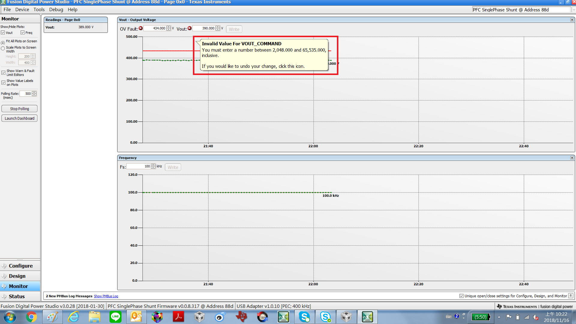

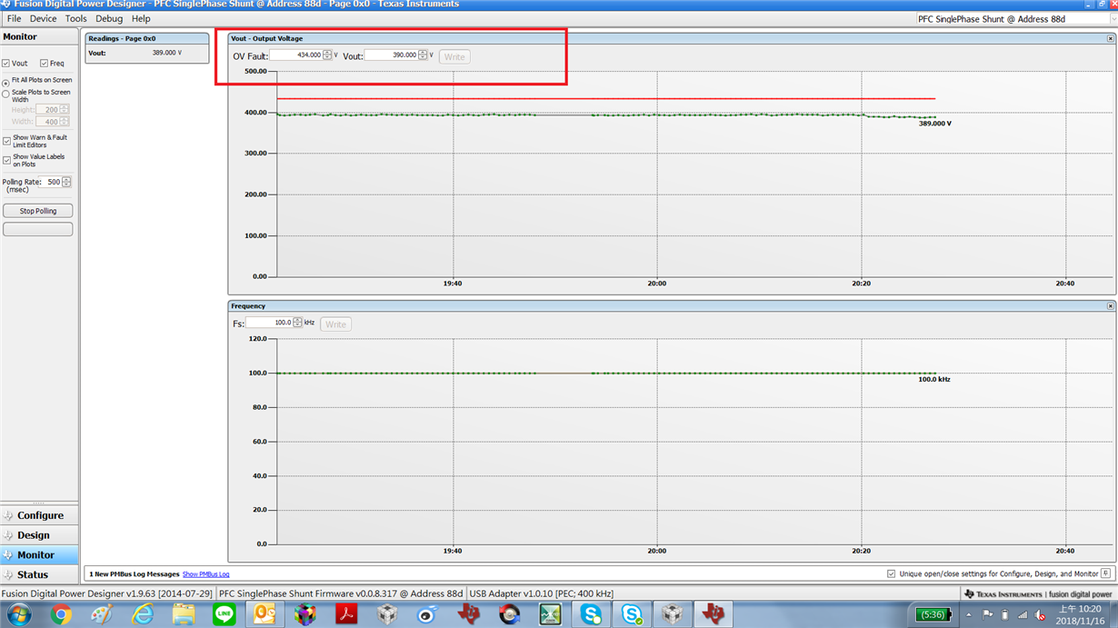

Hi ,
I'm using pfc ver1.2 sample code on PWR-026 PFC EVM,there are some differences between the fusion power designer and fusion power studio like this
V1.9.63
3.0.28
Who can tell me what's goning on with the fusion power studio,i can't set new Vout cmd directly,it seems to have to some transformation,thanks
