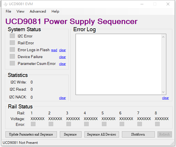

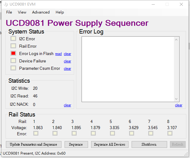

  • Hi Yihe,
    I can use the UCD9081 GUI to read  and "Update Parameter and Sequexce" the UCD9081 device, and the waveform was correct.
    After finishing programming, I closed  the software and opened it again. The GUI failed to connect the device. But we found replacing a new IC could make it work.
    new IC cloud make it work.
    after finishing programming

  • Hello Raphael
    Did you try the UCD9081 GUI? it has a option to load EVM Default Configuration.
    Yihe
  • Hi Yihe,
    Yes, I tried to use the UCD9081 and click the Default Configuration.
    Those values(0xE000~0xE1FF) were not changed but the user data was successful.
    Raphael
