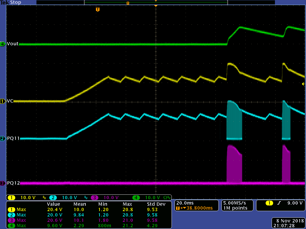

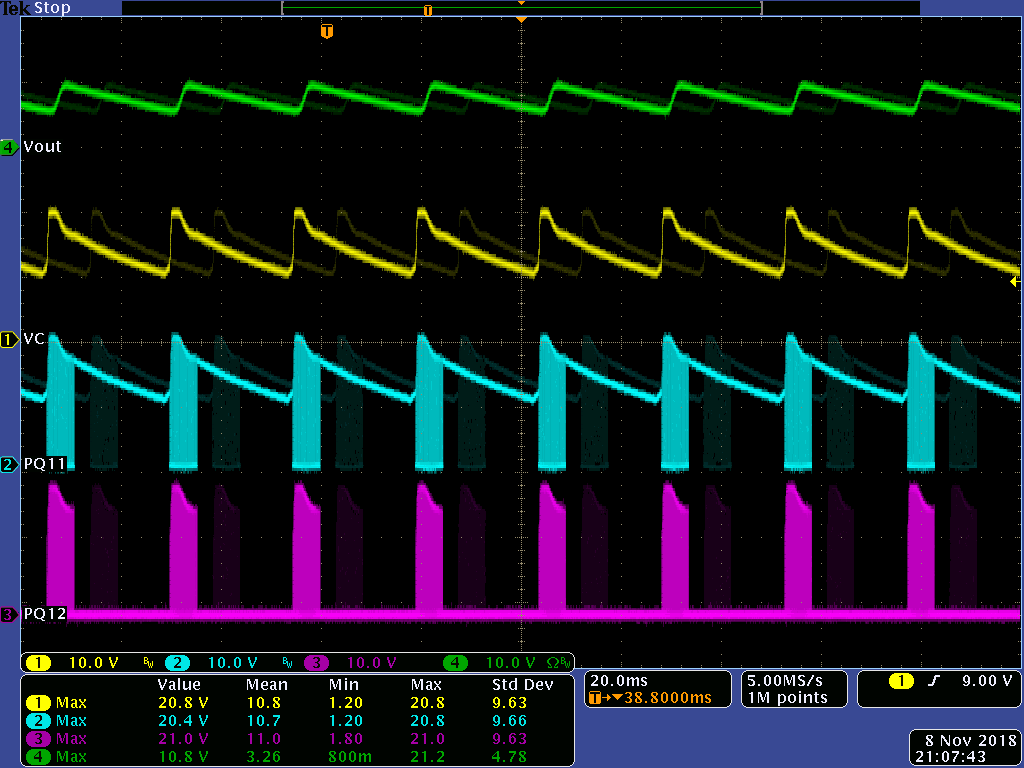

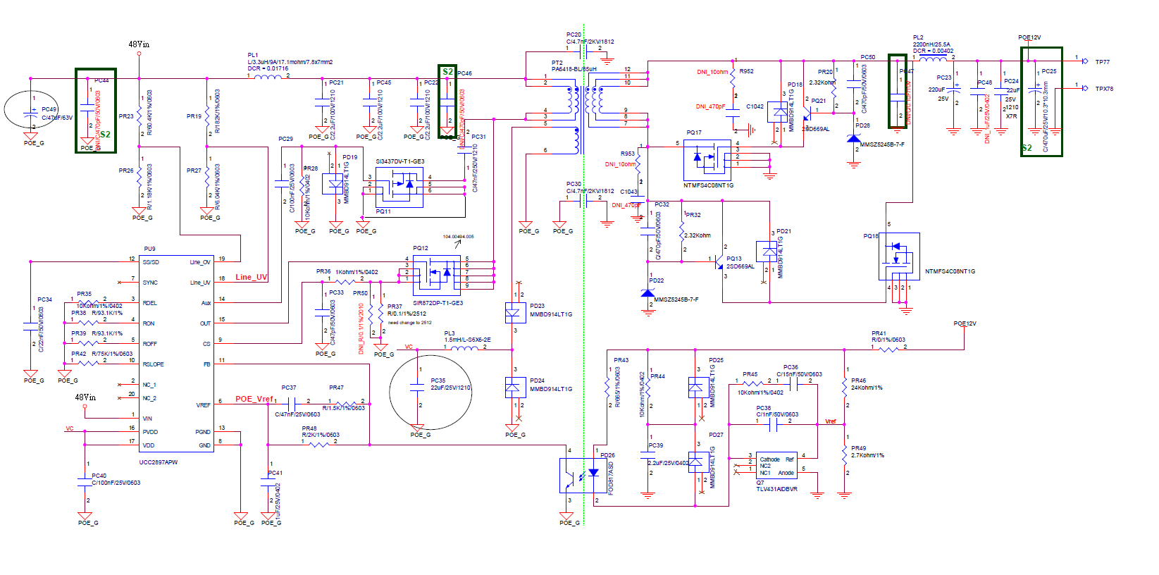

Dear Sir,
          Our customer use UCC2897A to design 48Vin to 12Vout/5A application. But the VDD voltage will over rating 16.5V. Could you help to double check schematic or components have any wrong? (VDD, POE_12V, AUX pin and out pin waveform as below.)
