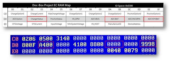

Hope you are doing well. When you get a chance can you help with how to interface with BQ25700A via SMbus. Customer is following below steps:
1. You can leverage IO Space to read and write 0xE300

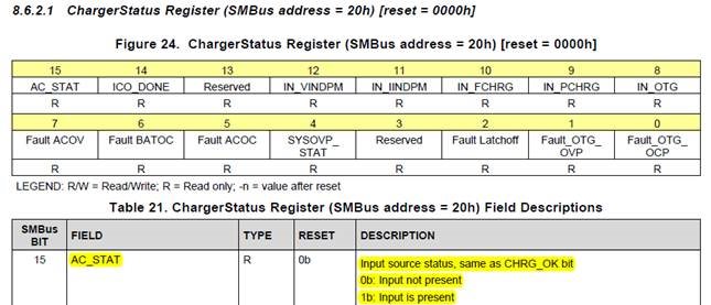

Charger Status Reg[0xD2], bit 15,0 (AC Input not present) / 1 (AC Input is present)

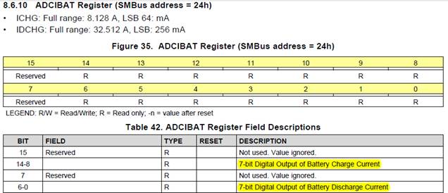

ADCIBAT Reg[0xDA], Bit 14-8, if it’s under charge mode,it will show charging current.
ADCIBAT Reg[0xDA], Bit 6-0,if it’s under discharge mode,it will show discharging/drain current.

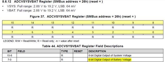

ADCVSYSVBAT Reg[0xDE],BIT 7-0  is able to read the current of  battery charge/discharge.
