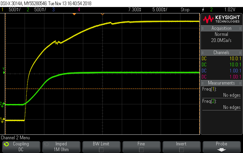

We are using FRONT END 0 (EADC and DAC together) in Successive Approximation Mode, while we found some timing issue;
when there is bias voltage(around 1V) on EAP0/EAN0 before or during V33 rising, the final SAR calculation is always zero, do you know why? if the bias voltage is unavoidable how to use SAR under this condition? thanks a lot;
waveform is attached; CH1:V33, CH2:EAP0/EAN0;
thanks a lot;
  • more information here
    1\when we change V33 to rise faster,like in 2ms to 3.3V, while keep EAP0/EAN0 the same rising time and voltage level, the reading is still zero;
    2\while if we reduce the EAP0/EAN0 voltage level a little, the reading is right;

  • Hello Jun
    I can replicate the issue here on the open loop board. Thank you for bringing it to our attention.
    It occurs even if the front end input voltage is brought from 0 to 1.0V a few ms after 3.3V reaches it's nominal value, so it seems like a genuine issue.
