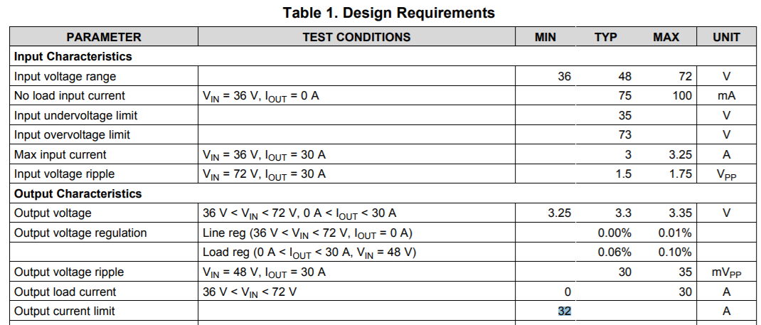

Dear Team,
How to setup UCC2897A's OCP?
On the datasheet, it mentions output current limit is 32A

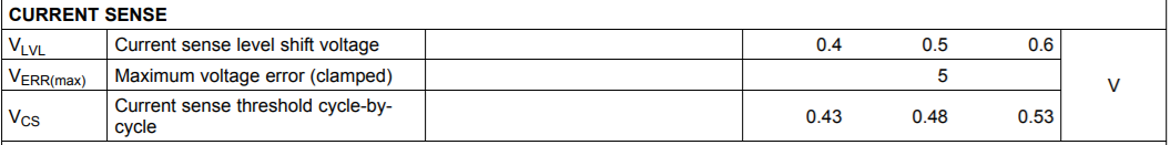

I think this 32A is cause by Rcs resistor and current sense threshold, right?
How to calculate it?
BR
Kevin
  • Hi Kevin,
    The extract from the data sheet which you attached is actually for a design example.
    You are correct in that the current sense threshold and the RCS value sets the current limit.
    please use the Excel calculator tool in your design and this will guide you with the current limit selection.
    John
