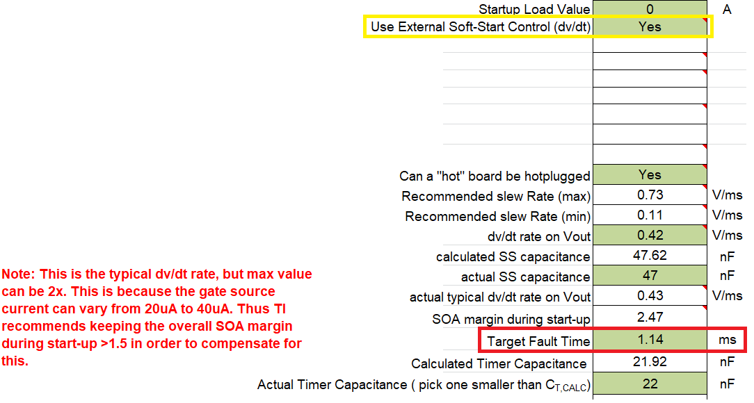

We have some questions about LM5066 Design Tool,
1. Is there min. limitation for Target Fault Time when using external soft-start control?
2. Could you provide the selection consideration for the external SS PNP transistor? Can we apply "LMBTA92LT1G" instead of "MMBT5401LT1G"? Datasheet: http://www.lrc.cn/data/pdf/LMBTA92LT1G.PDF
3. Please help to review the spreadsheet if the design follows it. Thanks!
