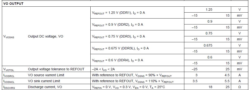

My customer will use LPDDR4 for their project, and I would like to confirm if TPS51200 could be applicable for LPDDR4.
Below Electrical Characteristics table doesn't refer to LPDDR4, but VVOSNS could be guaranteed 0.55V +/- 15mV for LPDDR4?
