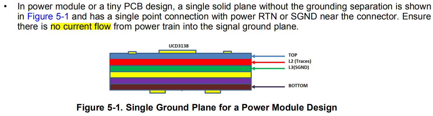

5.
I can't understand the meaning of this passage? I don't know what the yellow and purple layers in the picture do. Is it just two pieces of copper?

    5.
    I can't understand the meaning of this passage? I don't know what the yellow and purple layers in the picture do. Is it just two pieces of copper? Comments:  it shows different layers of PCB
  • Thank you,I get it.
