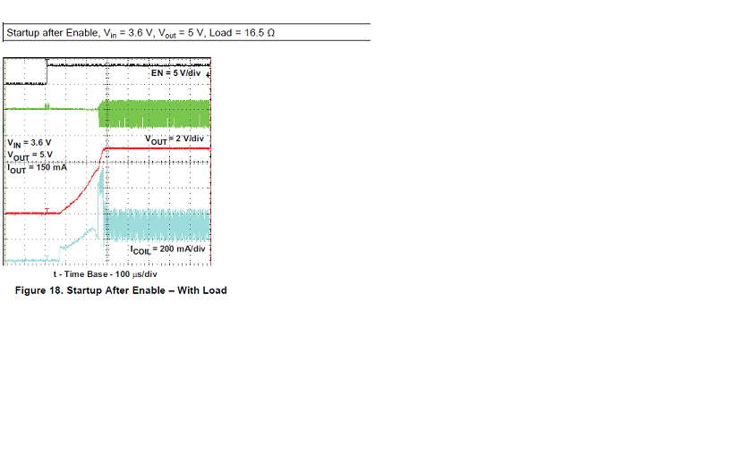

         Per TPS61240, some question as below.
1. What is the minimum output current? condition?
2. About the startup load:
It seems that the IC can be startup with 16.5 ohm load in figure.18.
a. Is 16.5 ohm the minimum load for the IC startup with load? How about 18 ohm?
b. With 16.6 ohm load, the current should be around 300mA.
     But Iout is 150mA in the figure, is it correct?
