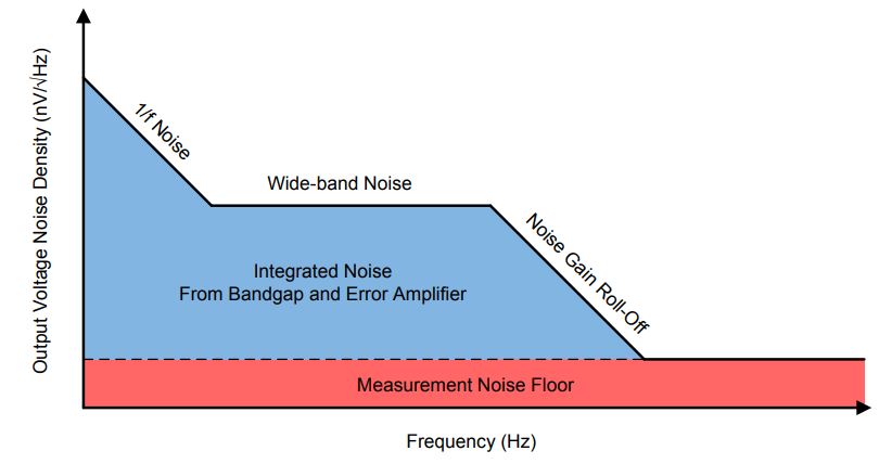

My customer needs a very low noise LDO in the 0.1 to 10Hz frequency range, while all our LDOs are characterized only from 10Hz.
Could you provide some data for this bandwidth?
