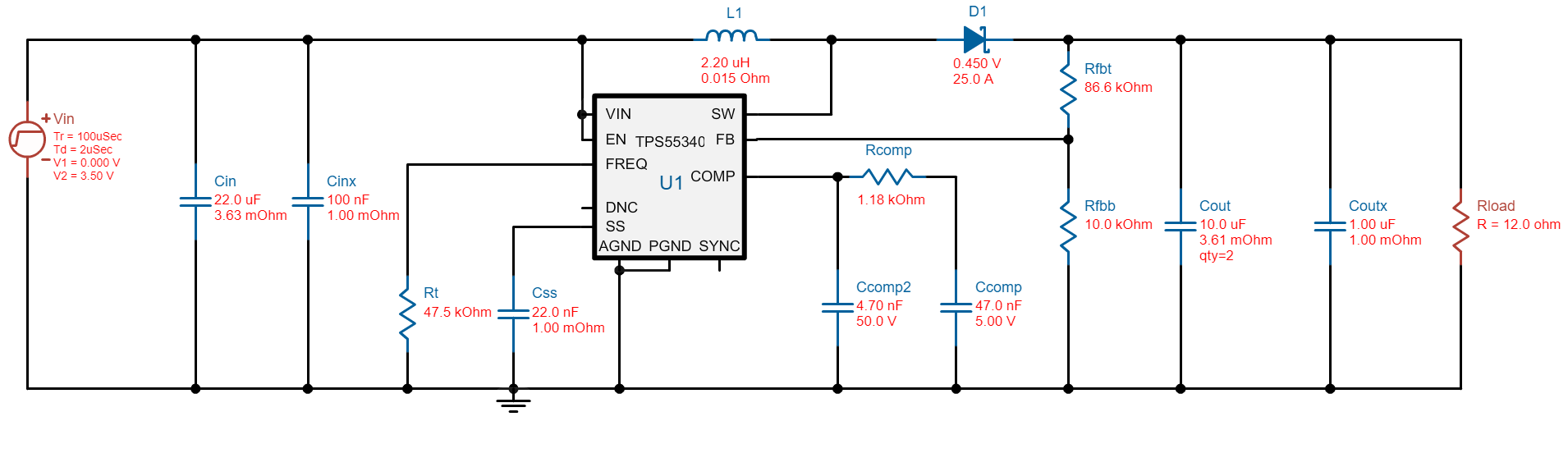

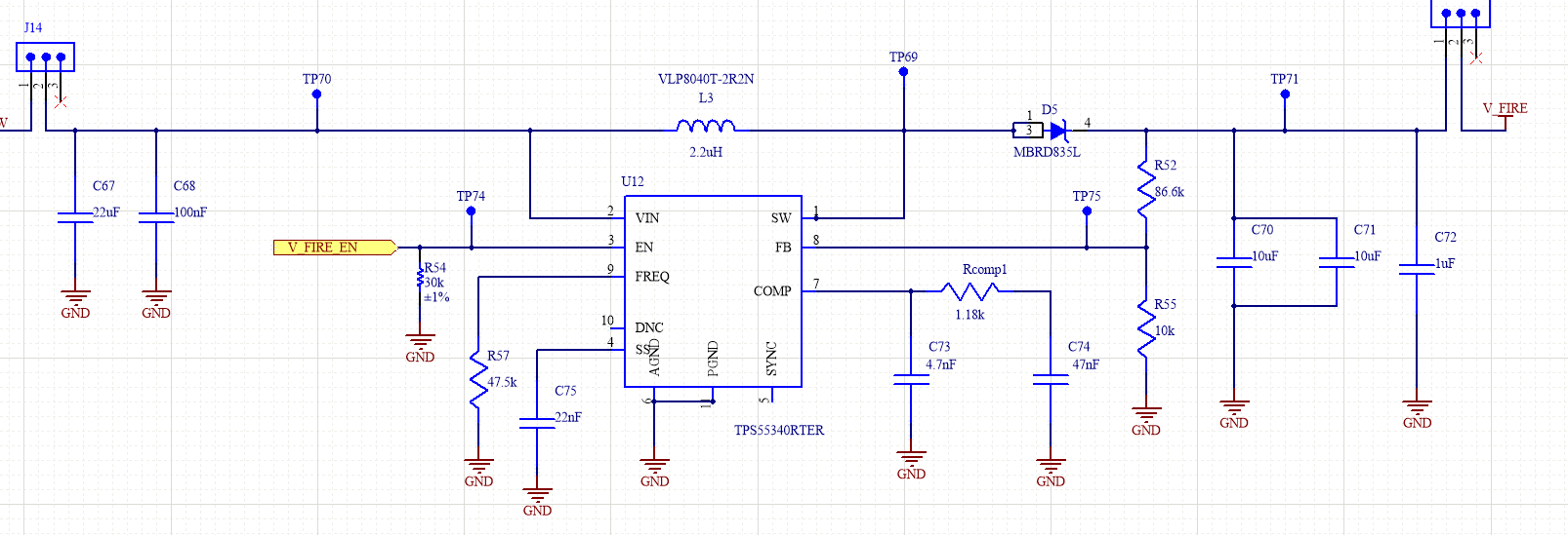

I am following WEBENCH design. When a load is connected, the power supply goes to CC mode. It does not stand any load.
Dear Sir,
What is the maximum output capability of your power supply? You need to use around 7A output level power supply. Try startup at the no load condition first.
