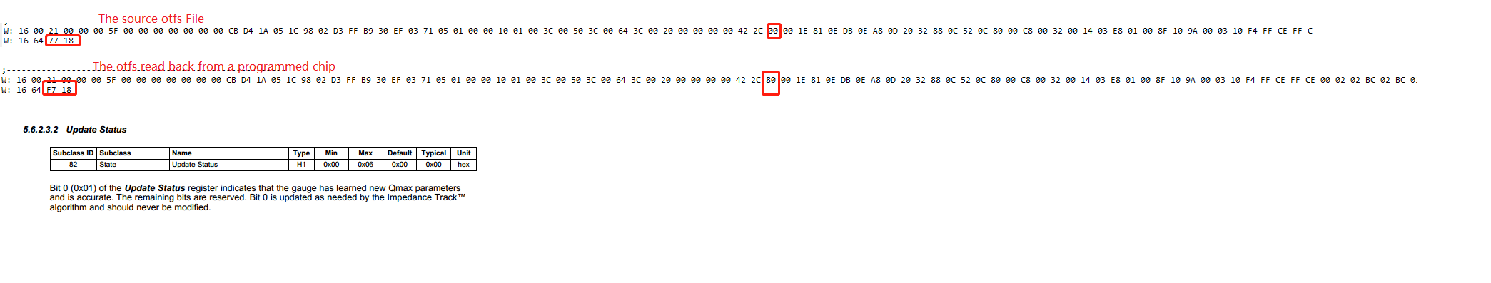

Hello,Dear,TI Members,
 I am a employee in a battery-packing-factory in china,I have a question about the format of OTFS file for bq27411-g1. now, we would like to develop a solution to program bq27411 for the production line using our i2c tool. so I want to know more details about OTFS file. i have spend several days on it, and the difficulty mainly focus on the bytes followed by the slave address--0x16 .for example:
W: 16 00 21 00 00 00 5F 00 00 00 00 00 00 00 CB D4 1A 05 1C 98 02 D3 FF B9 30 EF 03 71 05 01 00 ..........
0x16 is the slave address for rom mode.
0x00 is register command
0x5F is a count for the bytes followed.
so. how about "21 00 00 00 " ???
Thank in advance. Best Regards,
