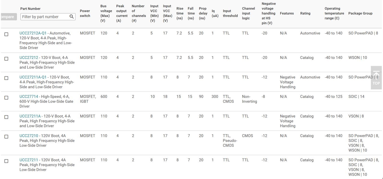

Moreover, I find Iq (uA)=1 for UCC27212A-Q1 and Iq (uA)=300  for UCC27212A-Q1. Does it mean that UCC27212A-Q1 can save more power consumption?

    1.  In the last mail, I mentioned the Iq due to the following table. Does it mean that UCC27212A-Q1 save more power than UCC27714?

    1) During stand-by, the UCC27212A-Q1 will consume less power than the UCC27714.
