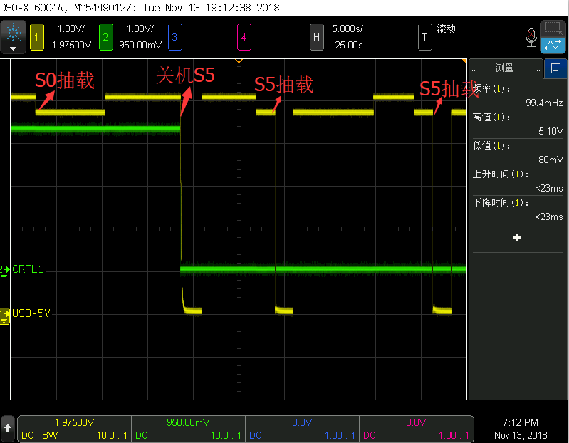

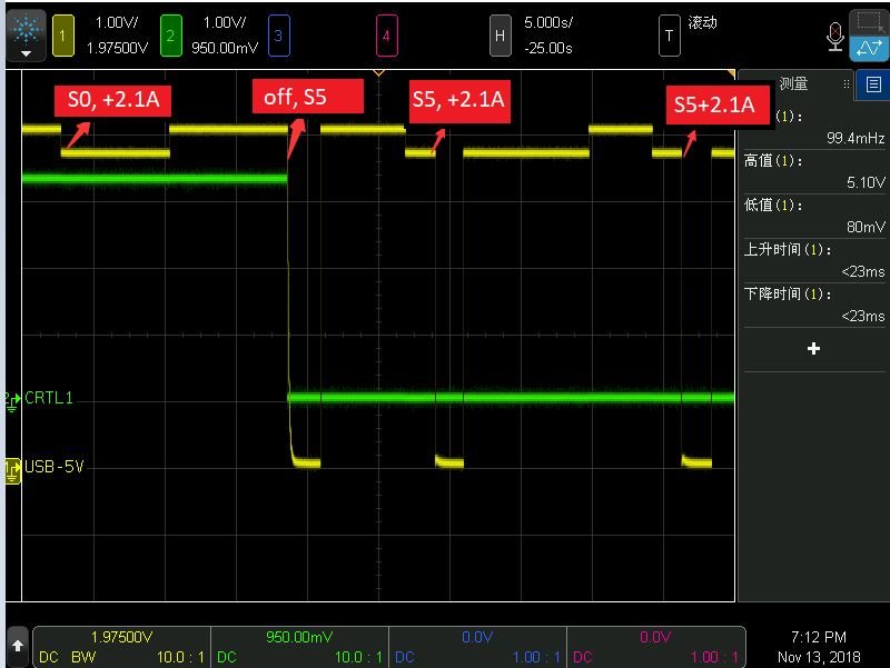

Customer is testing TPS2546 in notebook system and got below waveforms.
1. When system in S0, CTRL1/2/3=111; When system in S5, CTRL1/2/3=011.
2. When system in S0, drive current 2.1A,there is no VBUS drop.
3. When system shut down, change from S0 to S5, CTRL1 change from 1 to 0, VBUS will drop to 0 and then back to 5V, is it normal?
4. When system in S5, drive current 2.1A, VBUS will drop to 0 and then back to 5V as well, is it normal?
Could you let me know where I can find the explanation in datasheet? Thanks.
Note: in below waveform, 抽载means drive current 2.1A, 关机means system shut down (change to S5)

  • 3. When system shut down, change from S0 to S5, CTRL1 change from 1 to 0, VBUS will drop to 0 and then back to 5V, is it normal?
    This is normal behavior because when the change of mode, the bus is discharged and then the BC1.2 state is renegotiated.
    This is not necessarily normal, but I need to know what it happening on the D+/D- bus to debug what is happening.
    Please ask your customer if they have the D+/D- bus captures available. There is a negotiation that happens between the device and the TUSB2546 that needs to be observed to describe the behavior.

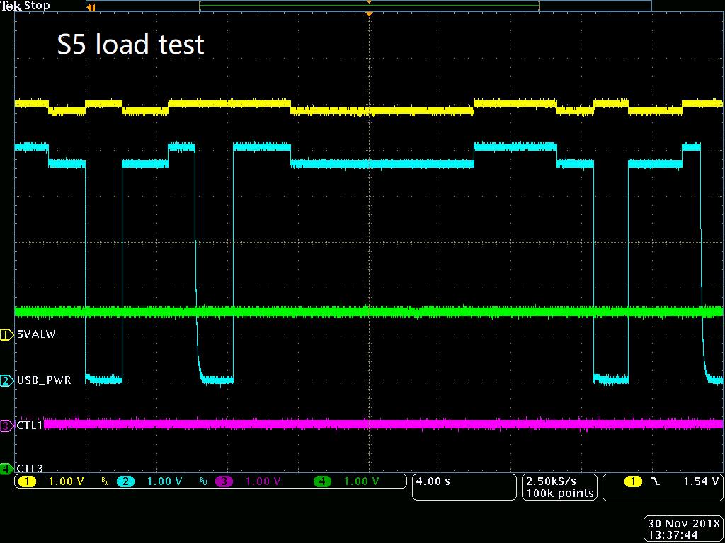

           A few more tests are done to provide more evidence for this phenomenon. The following is the loading test under S5(CTL1-3, ILIM: 0111).It appears that the discharges happen sometimes  after loading or released for 2s. And regularly, the discharge happens if the loading period is short.

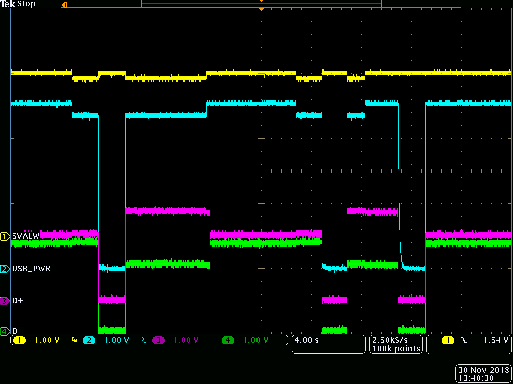

    Also here provide the D+ D- wave forms when discharges happens under S5.
     2
    Could you please help to explain the reason for each discharge based on these waveforms? Thanks very much.

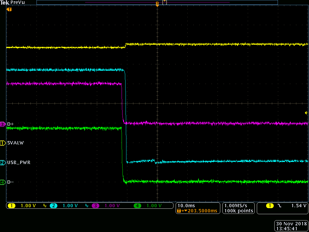

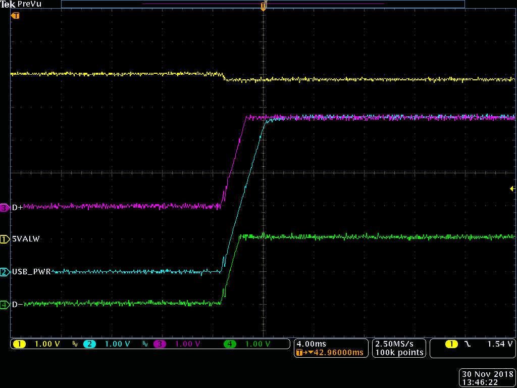

    Down here are the rising edge and falling edge captures for the discharge in case they are helpful.
    34
  • The D- state changes that I see in this diagram is not caused by the TPS2546. It appears to me that a change in D+/D- is causing the state change and the discharge.
    I suggest that the the customer look into why the connected device is changing state on the D+/D- lines.

    It appears that the device is doing a primary and secondary detection to differentiated between SDP and CDP. The first detection fails, then the device discharges the bus and the attempts a second bus detection with 1.2V short mode and this also fails and the device ends up in SDP mode at the end of the cycle.
    I cannot be sure because I cannot see the D+/D- lines.
