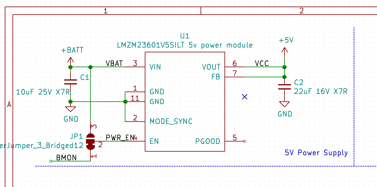

LMZM23601: Module goes pop!
Part Number: LMZM23601
I have a design using this device and I'm following the design to a T, yet I'm getting 12V showing up on VOUT and causing everything to pop. The only thing I can think of is that Cin is not right next to Vin. Note that the person testing this after two boards failed did not hook up Cout. Is there any reason why this should fail? Note that only the buck and C1 were installed and EN was shorted to Vin. Vin is nominally 12V.
If the input voltage comes up slowly, Vout is quite low and the device gets extremely hot. I'd swear the device was installed backwards or something, but his pictures clearly show the dot where pin 1 should be and everything looks good.
When everything was installed properly and EN was pulled low, he saw +12V on the output. This was with both C1 and C2 installed. After testing, he also saw +5 shorted to ground, but this was not the case before powering it up.

    I agreed with you that your input cap is quite far from the input pin. If possible place it closer to the input pin to reduce high di/dt loops and noise ringing through to the switch node. When you described that your system "pops" what current loading do you have on it? From your schematic it looks like your application is 12Vin to 5Vout.
    Are you measuring a VIN short to VOUT? I'm curious to understand if your system experienced some EOS that damaged the HIGH-side FET. It also sounds like you have a VOUT short to GND issue as well. Can you confirm?
    Jimmy
  • It sounds like the person who has the board hooked up the power backwards, so this can be closed for now.
