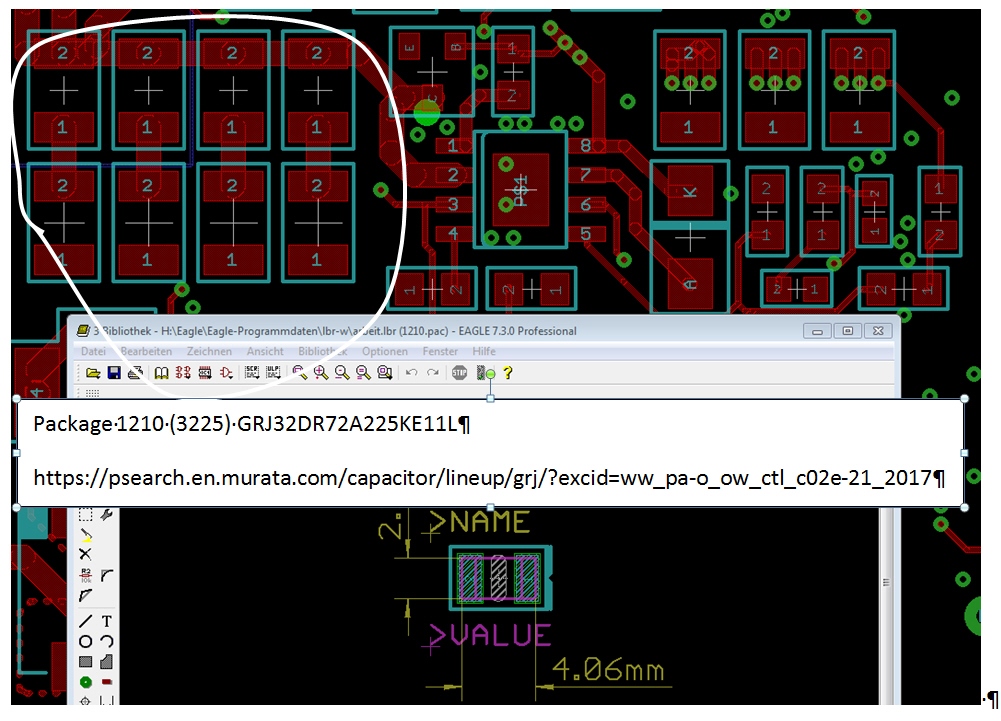

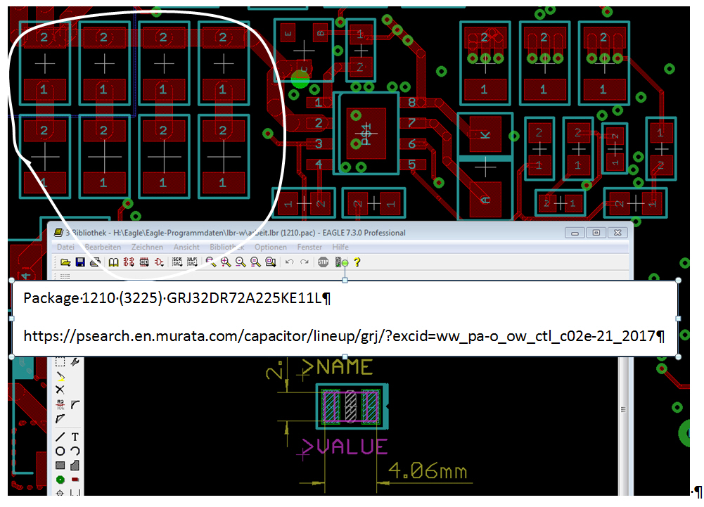

first in my application I had used MLCCs at the Input - but they are "singing" and had made music!!!!
Now I had changed to alu-capacitors and everything is fine ....
In the DB TI suggest ceramic-capacitors (low ESR) - but they don't say, that I must not use alu-elkos (higher ESR) ...
So are there other reasons against alu-elkos - because I want to use them for series!!??
Thanks for your feedback in advance.
